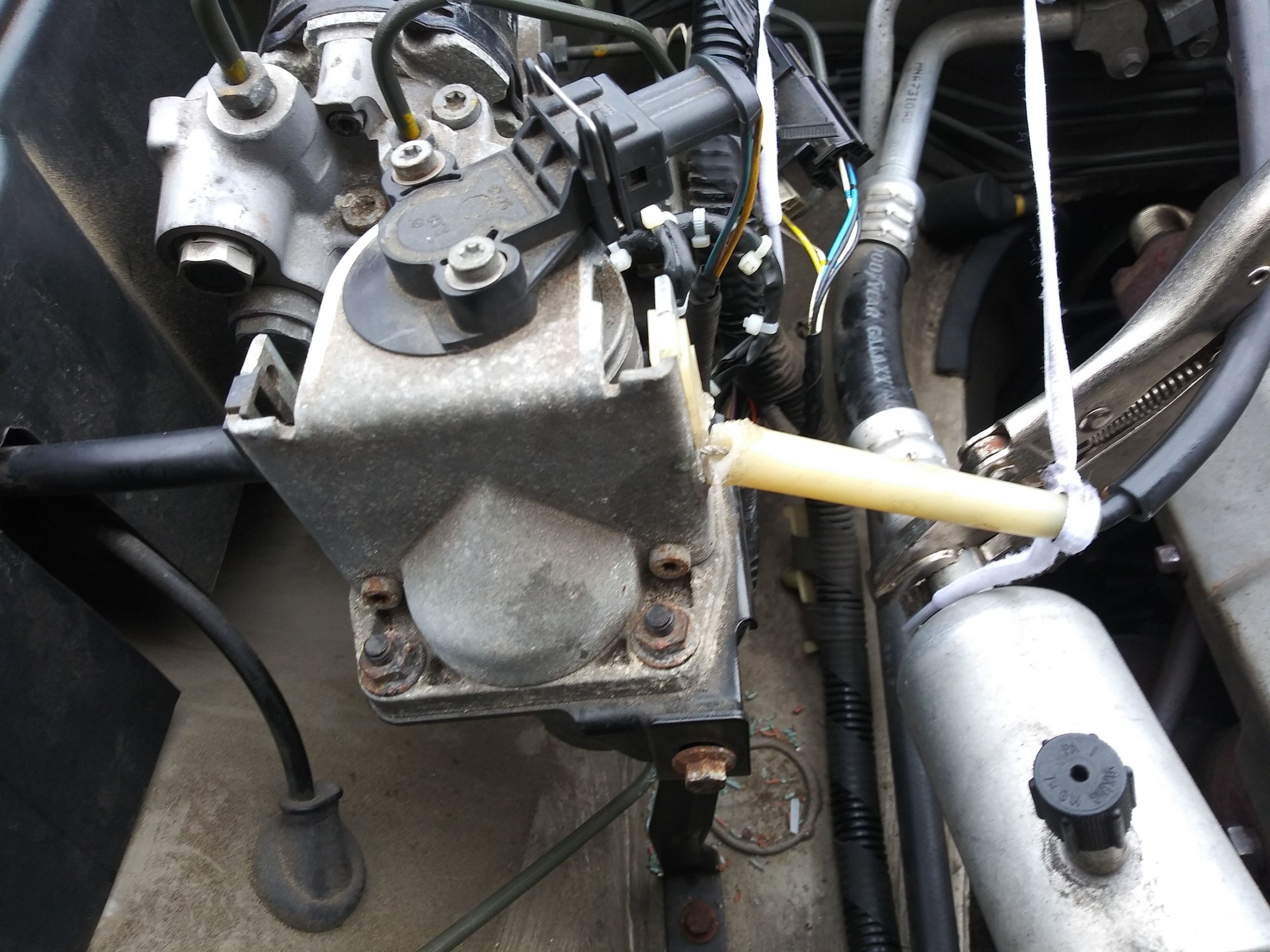

Does anybody have ideas on how to fix this ? The cable from the cruise control vaccuum runs through here. Not driving car much at all due to other issues so just threw in a shoelace and vice grips to hold it up a bit if i have to rev the engine for a minute.

I have NOT seen one that was NOT broken in a few decades!!!
I have seen plastic glue, epoxy and other advesives used.
I would fashion an L bracket and a small screw into the upper plastic piece.
You can use 'zip-ties' to hold the L bracket to the round tube part?
Lots of ways to hold it in position.
The part is NLA from Jaguar!!
By The Way that is a TRACTION CONTROL ACTUATOR. (nothing to do with cruise control)
I have used JB weld and worked great Put it on about a year ago and still working great. I actual used superglue the first time and it worked a while til I leaned on it again and broke it again. I have a complete one that I pulled out of another car but not sure I am will to part with it since it does break based on where it is.
Will try that JB weld. Thanks.
