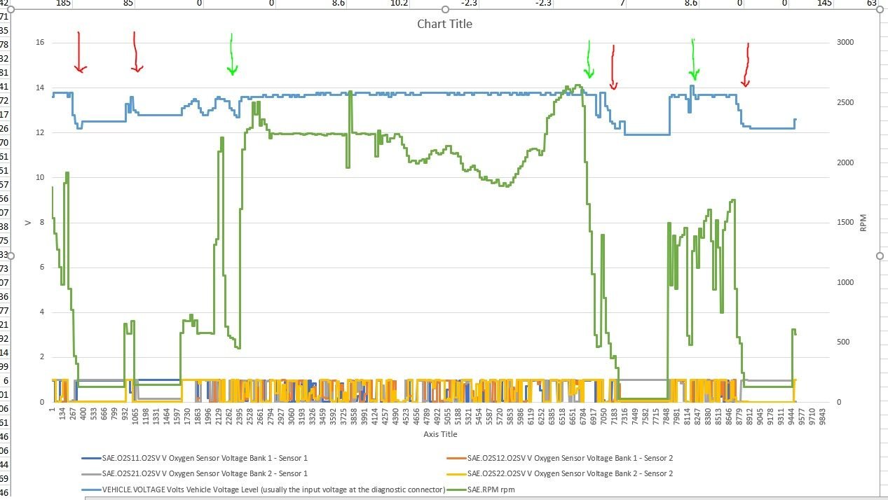

I have an OBD2-tool and it only shows me error code P1621. I don't think it has anything to do with the very high fuel consumption. But I'm not sure.
I'll take a short drive later and record the OBD2 data while I'm doing so. Let's see what the values say then.

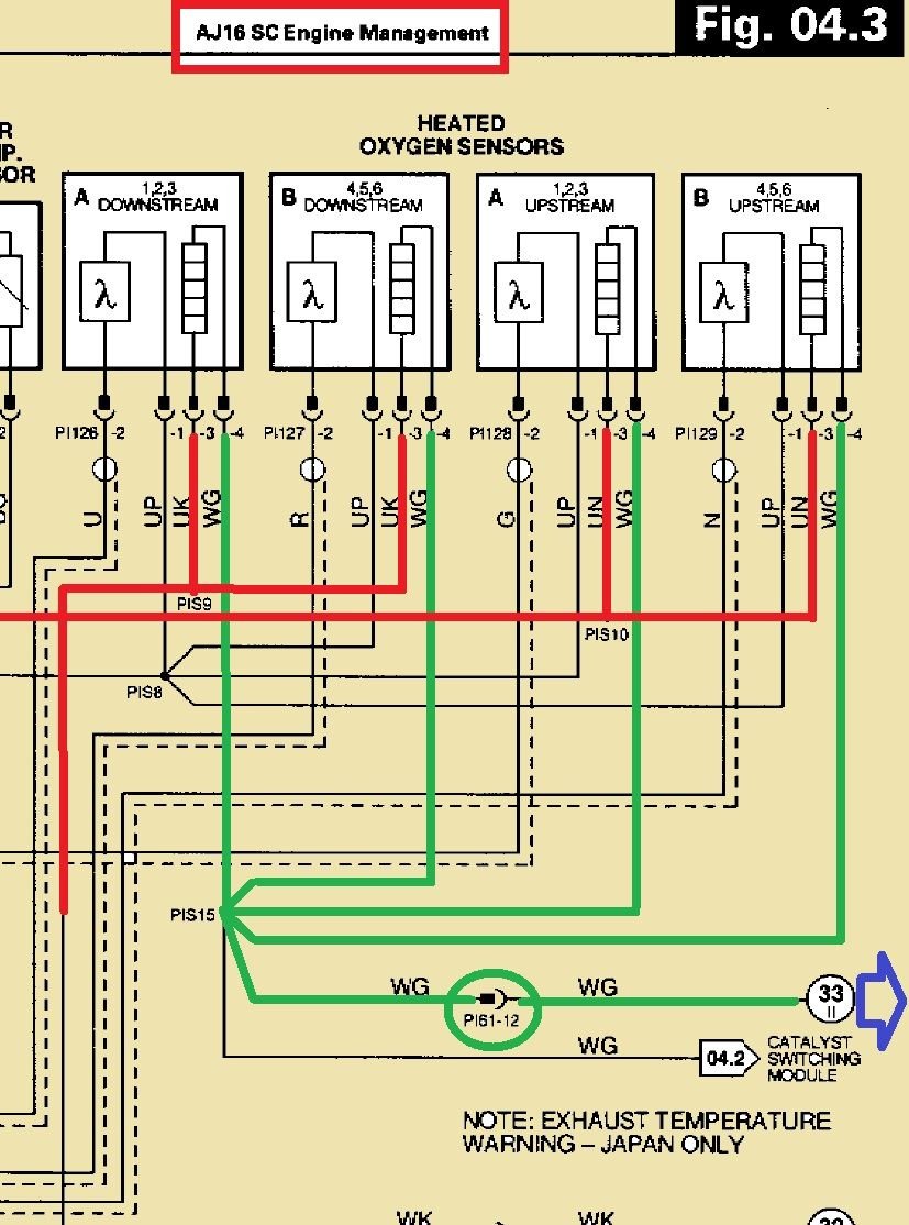

The O2 sensors are different Titania based sensors ( they operate totally differently ) that may not be picked up on your live data reader ( looking for the more common ) and the end result of the sensors being active and correct is the ECU / engine resulting in the short term fuel trim target 0.0 %
The O2 sensors even being able to give a correct signal is based on if they are heated up ( the sensors themselves ) to operating temp of X ( sensor physics ) , I question the X300 live data graph below as the O2 sensors readings stay constant
There is one fuse ( heating elements inside )2 sensors ) for all four sensors as right engine bay fuse box # 10 , 12 , 14 , 16 without looking it up , and a connector ( Papa Indy 1 and Papa Indy 61 ) subject to a TSB that this one fuse wire goes through . Wire is in Papa Indy 61 position 12 as White / Green color wire
The accuracy of the O2 sensors return wires is dependent on the wires shield ground ( it is a miny coax cable ) as the small ground studs on the engine rear firewall
I had green corrosion on the rear sensors ( only ones used for engine regulation ) connectors , do not mix up the connector hookup location as they can be swapped and cause issues like maybe yours
This would be red color ECU connector

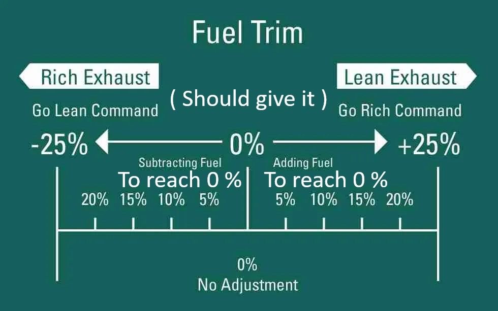

Can you pull the LTFT (Long Term Fuel Trim) from the car using an OBD2 reader?

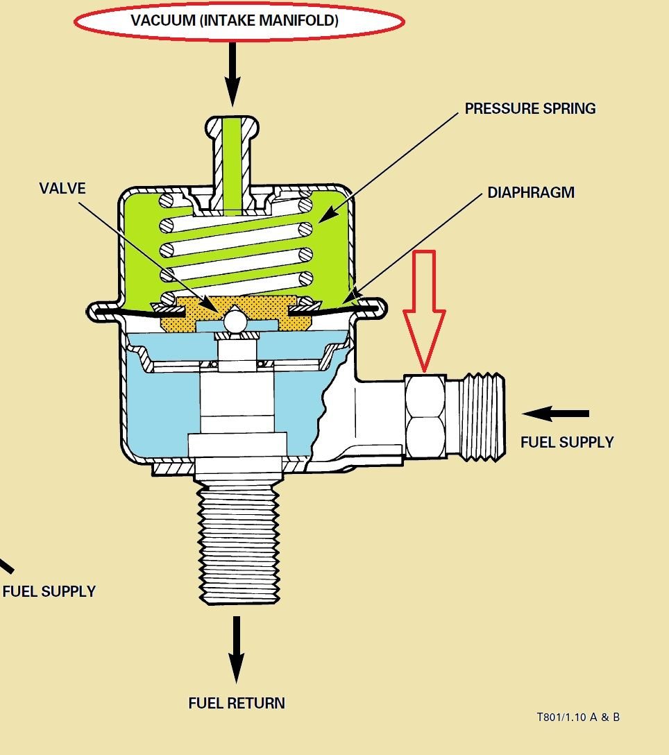

Its going to be worth Checking the fuel pressure at the fuel rail if your issues are not yet resolved ( not so easy as there is no additional ports to do this ) my fuel pressure regulator failed and was causing almost identical symptoms to the OP's post.
In the end i welded a port to a second hand fuel rail and fitted a manual gauge so i could witness the fuel pressure . This was a couple years ago and the numbers escape me but it was significantly off. I fitted an aftermarket reg remotely mounted.
There is some really great advice in this thread - but don't get to caught up on logs and trim tables and OBD . Fuel pressure is not reported on these cars so to my knowlage it will not trigger any kind of fault or code.
Old Oct 29, 2025 | 08:42 PM
Parker 7's Avatar
Joined: Aug 2021
Posts: 4,653
Likes: 1,318
From: Kansas City
Fuel pressure is set to 43 PSI ?
