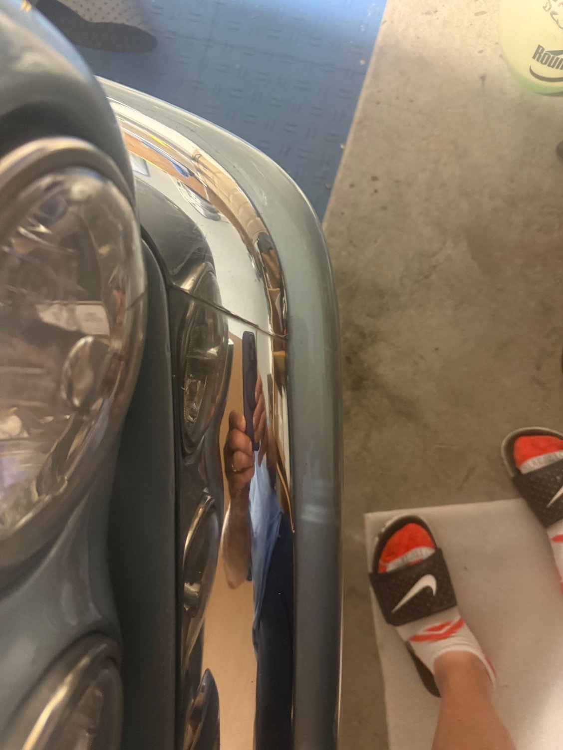

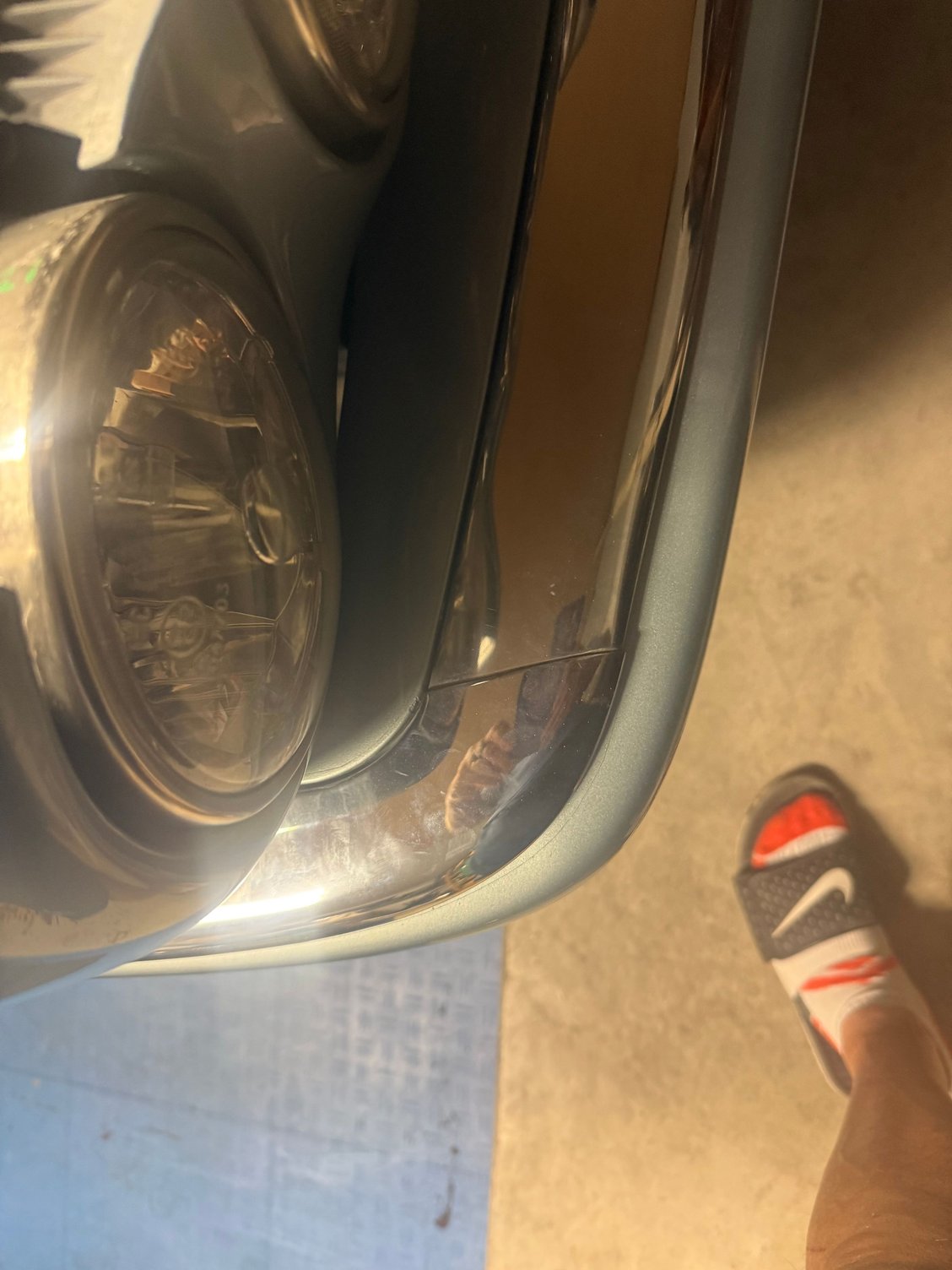

Here you go. Tried to make adjustments and pull it in. Nothing happen that much. I backed the nut back out and noticed that the nut backed out but the shock did not go with it. I am thinking that shock is toast

damn that is a long way out!.
it def could be that the shock is cooked and is over extended out.

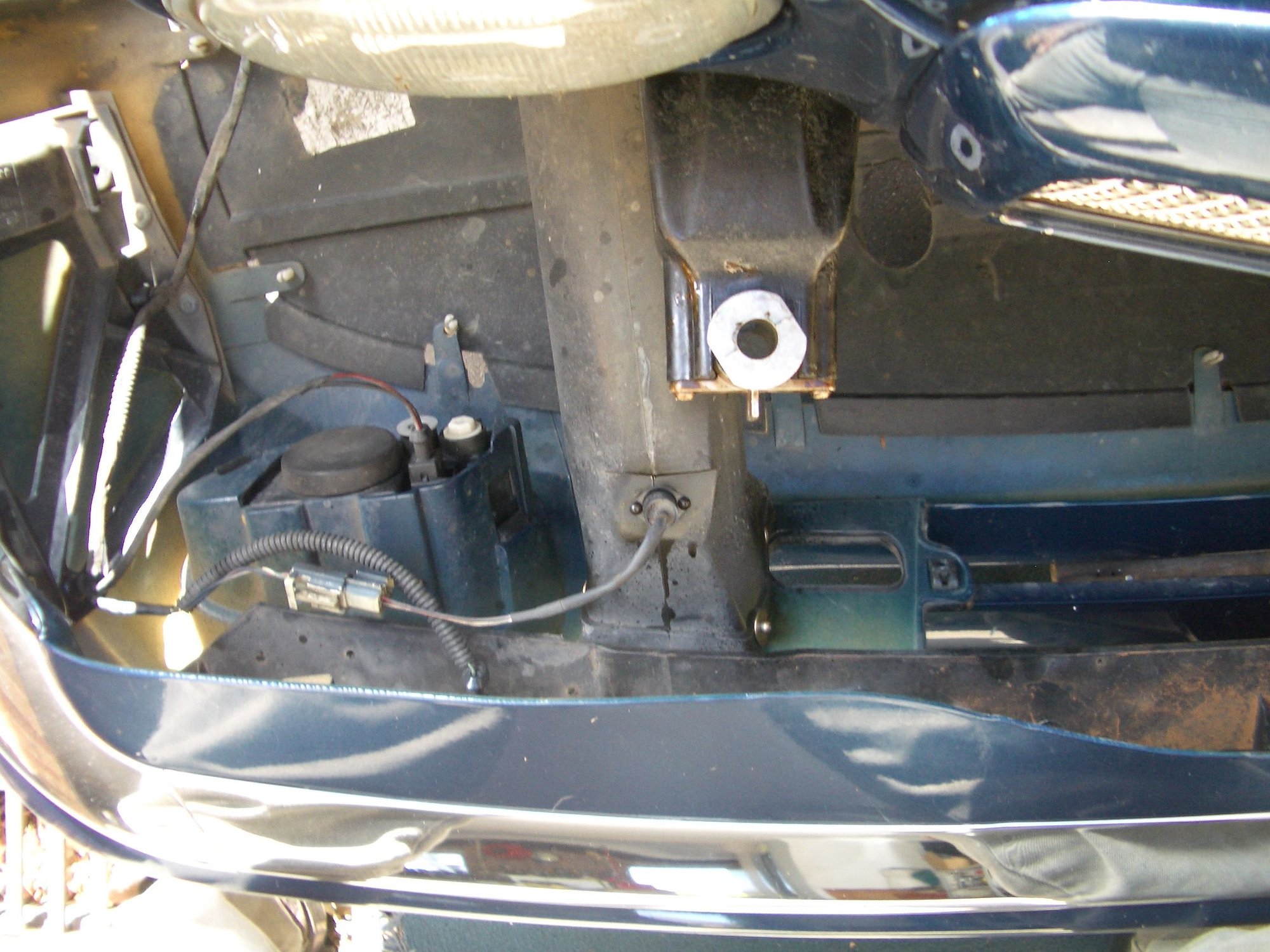

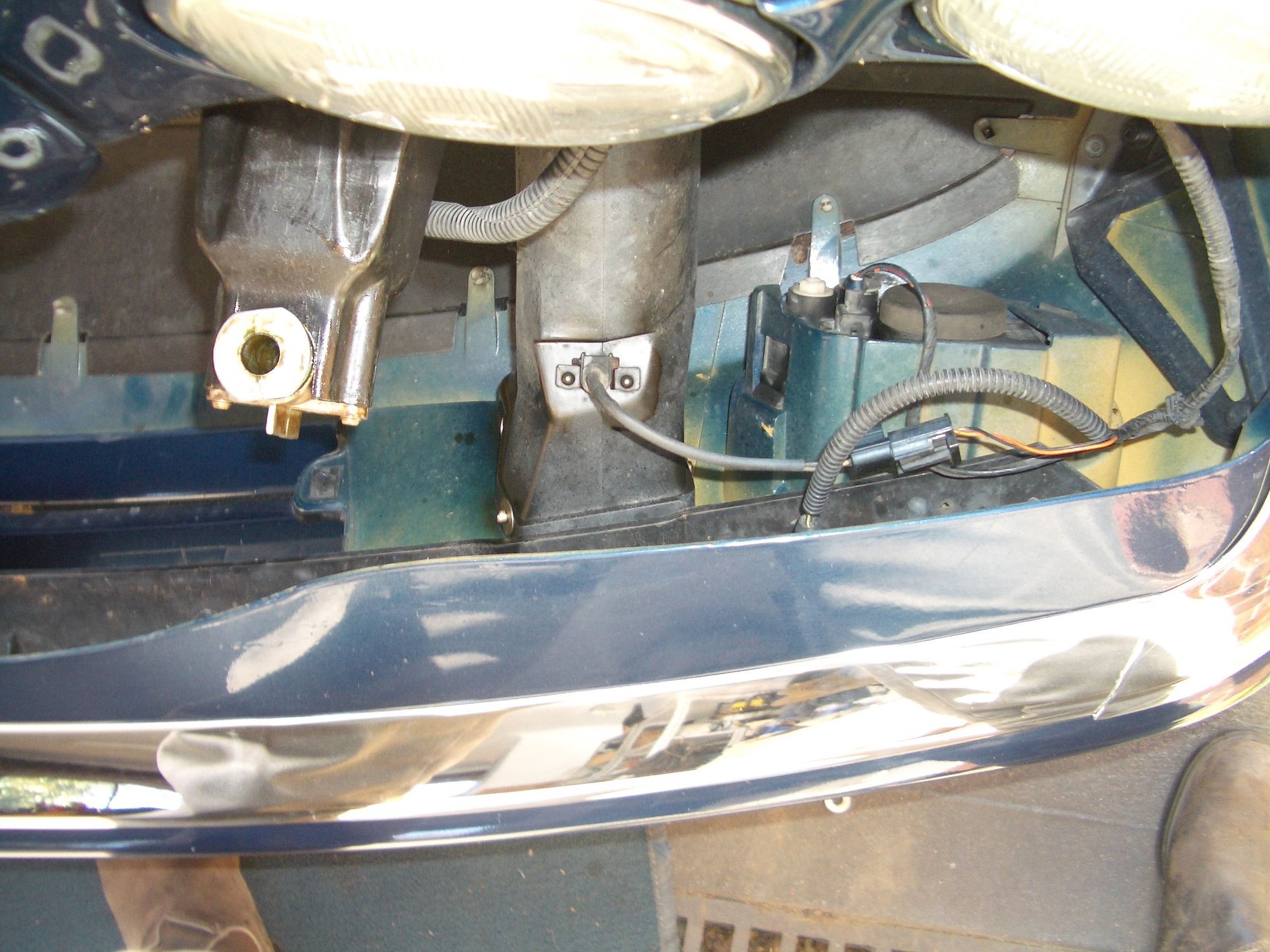

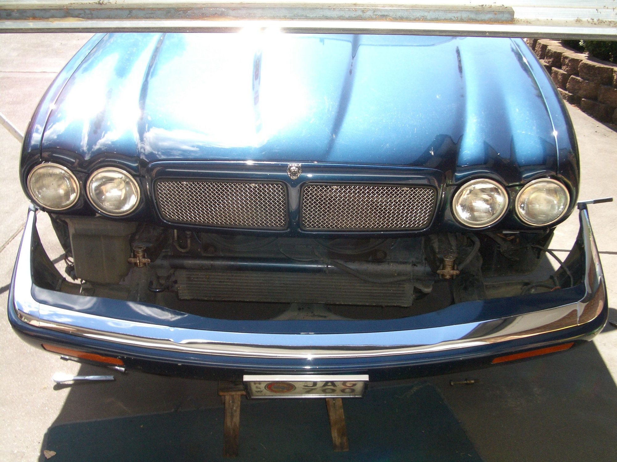

G'day Phil,
The only way you're going to find the cause of the misalignment is to take the bumper off the car. It is pretty easy, only two large bolts and as it is the front bumper corrosion shouldn't be an issue. Don't forget to unclip the undertray from the front wheelwell area and also the brake cooling ducts..
If the energy absorbing mounts are no longer available you could probably mail order source the fixed mounts and just replace them.
I have included a couple of pix of my front bumper when I removed it, it is an Aussie car so it has the solid mounts.
Cheers,
Jeff.
