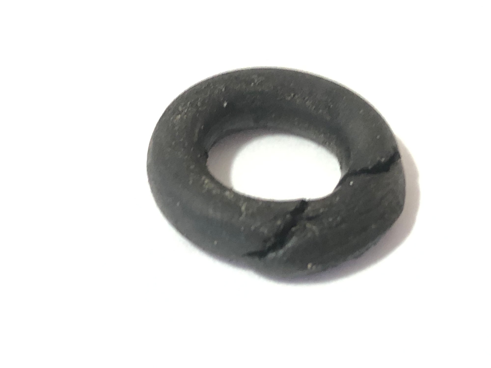

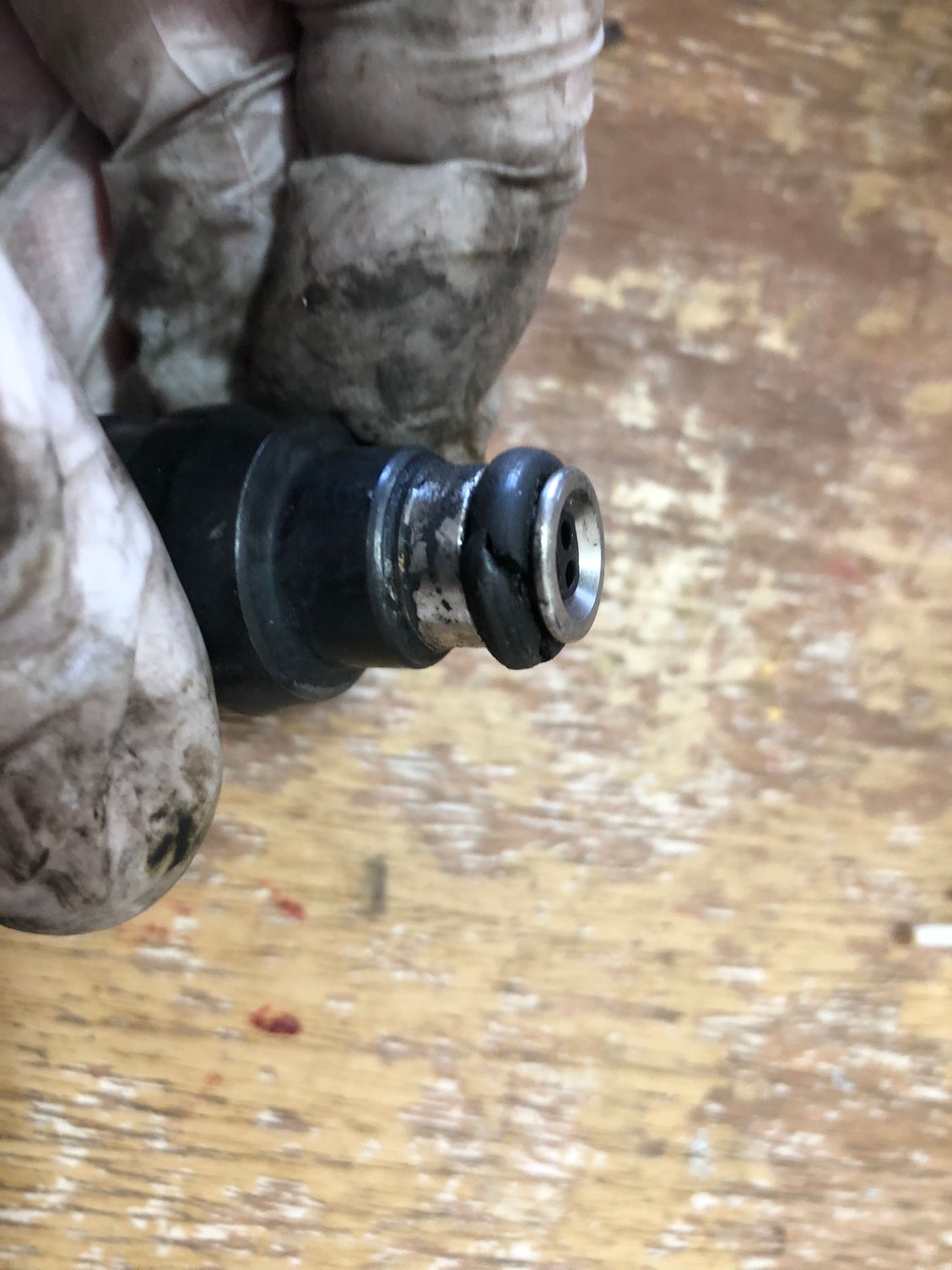

Here's the update.
I finally got some time to look into this and thank you all for the advice, which has really helped me to figure out the issue.
I did a smoke test on the Intake Manifold and this showed nothing. I then tried the brake cleaner method of lightly spraying in the vicinity of the noise, still nothing.
Today I took the fuel injector cover off and used the soapy water method and although there were no bubbles I could hear the water being blown or sucked by a leak
It was around the 4th from front fuel injector on the engine side seal. After removing the fuel injector harness and rail, I removed the 4th injector and found that the O-ring had been pinched and was not sealing correctly. This is where the hissing noise was coming from.
I used a spare injector seal from an old set and reinstalled everything. Now the hissing noise is gone, I can still hear something but I think it is probably the normal air flow within the engine (trying to not be paranoid).
I'm going to order a set of injector O-rings in any case as they are probably due for a refresh, hopefully that will close the book on this issue.
One thing that I'm not certain about is why the engine ran so well with air getting into the mixture. I had no error codes or anomalies with fuel consumption or misfires.
The only thing I noticed on a test drive was that the fuel MPG's is updating every 10-15 seconds which used be every few minutes, is that normal now?
Once again, thanks for the support.
There's the bugger
O-ring removed

I didn't think that a broken injector O-ring would make such a noise. For some reason I still feel doubtful but it did make a difference.
I am planning to replace all of the O-rings and injector baskets as this seems to be a cheap and easy job, so will post results when that is done.
For now I have a before and after video, which shows the hissing noise before and after I replaced the one O-ring.
