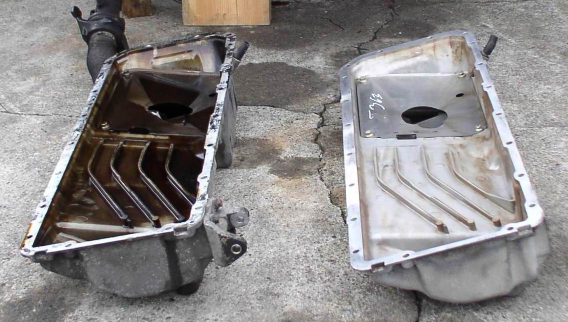

Likes: 17,009
I once purchased an X300 from a guy who had done that.
Unlike Doug, i didn't get paid to change it!
