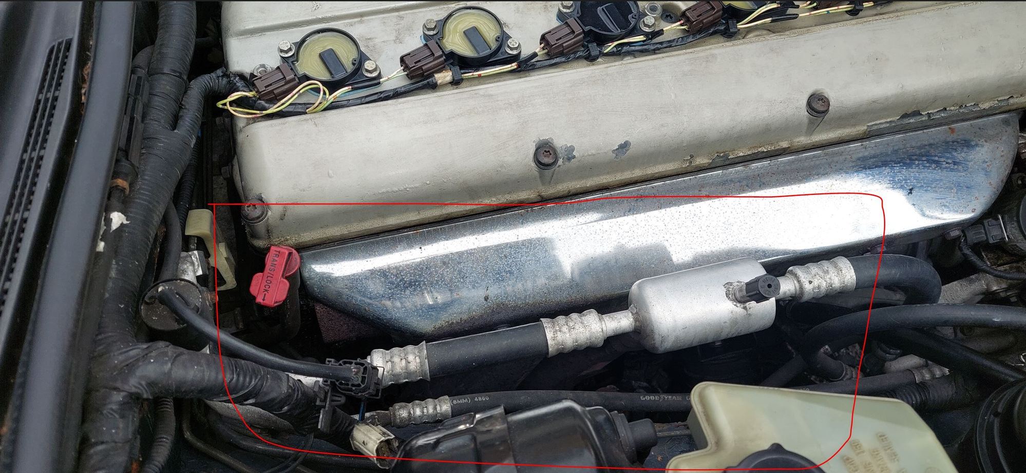

I've read lots of articles on this site and others about loss of power and misfire causes. I observed when the car limped to a stop the other day, exhaust fumes coming from the area highlighted when I first opened the bonnet. Just prior to this quite an unpleasant exhaust smell entered the car.
I'm thinking the CAT may well be screwed and causing the issue. I just wondered if anybody else had a CAT fail (melt) and what happened / what were the symptoms.

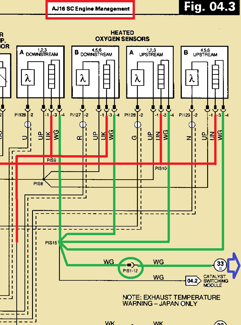

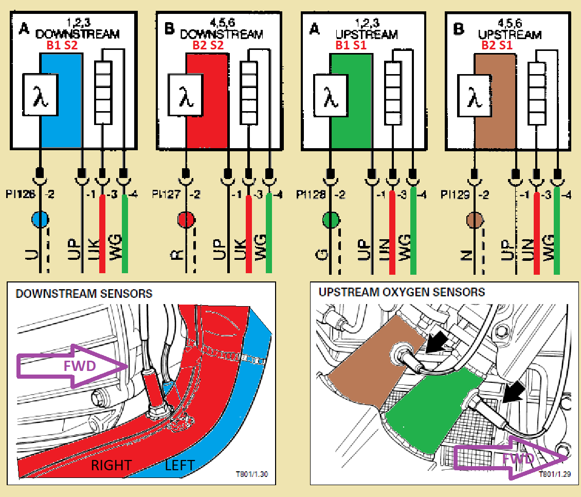

Beforechanging sensors there are some things to help them out
There is 1 fuse for the 4 sensors to heat them up so they will operate and read correctly
This single heating wire passes though the Papa Indy 1 connector that has a TSB for corrosion
You can put a meter on the sensors heating elements to confirm if you have a target sensor in that aspect
Only 2 of the 4 sensors are used in engine regulation and the other 2 are for Cat effecientcy comparison code
The grounds that protect the return signal can be cleaned and I found green corrosion on the aft sensor connectors
important to not mix the connectors installation as they can be and this will give you some mid time ECU relearning of the sensors operating parameters

The 2 aft O2 sensors are for engine regulation
See page 80 - 81
801S TITLE (jagrepair.com)
The ECT sensor can be calibrated against page 79 using a resistance test driven by a 9 volt battery
So above 88 C closed loop trigger point you should see below 250 ohms
