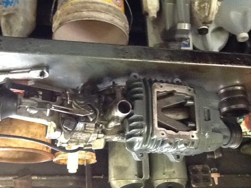

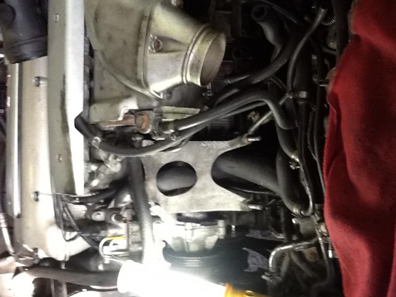

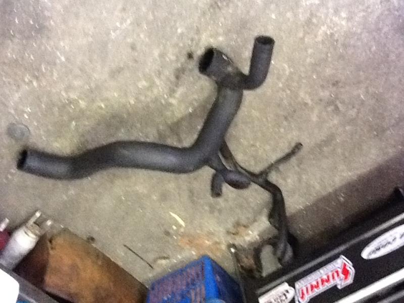

Surely the engineers at Jaguar were looking to make some techs Suicidal when the designed this hose and its path.
Well it was a "have to do" job as the hose was leaking and my supercharger was making some loud thumps and I had the bearings and coupler for the snout.
Pulled and installed the supercharger in one piece, new lower hose, air filter. oil filter, oil and some brand new belts.
Tomorrow on to replacing the sagging headliner as the new fabric arrived today.
Attached Thumbnails Lower Radiator Hose XJR 6 Cyl-supercharger-assembly.jpg   Lower Radiator Hose XJR 6 Cyl-hose.jpg   Lower Radiator Hose XJR 6 Cyl-engine-view.jpg
