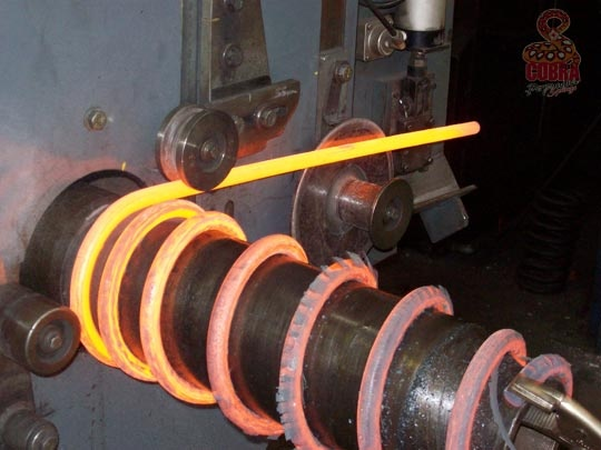

These new springs will be approximately 30mm shorter and a bit stiffer. They have been professionally designed for my XJ6 X300,
taking into account the weight of the AJ6 to ensure the correct tension increase,
So I won't be cutting standard springs!!.
