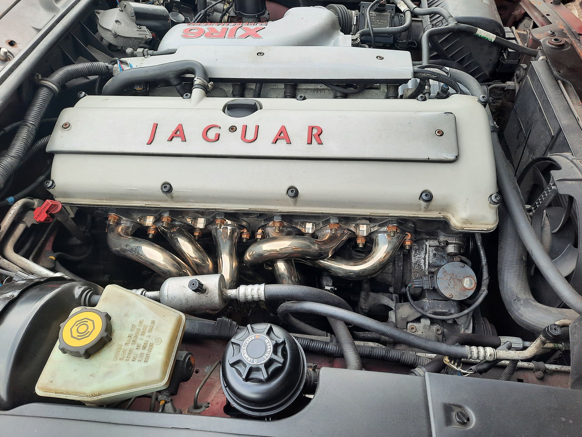

The other thing I have is a Howard and Scott exhaust manifold which is based on a design by Andy to give maximum benefit, looks very lovely too! It is definitely not cheap and gives the smallest benefit of the upgrades but I don’t begrudge spending money on my hobby…….

I note on your extractor photo you neglected to refit the original spacers to the exhaust studs/bolts.
Why?
Having recently fitted a similar set my understanding is that the spacers give more physical length to the stud/bolt which gives more clamping stretch and allows more tolerance of the expansion contraction process during heat cycles leading to less chance of the bolts coming loose, the better clamping lessening gasket leaks.

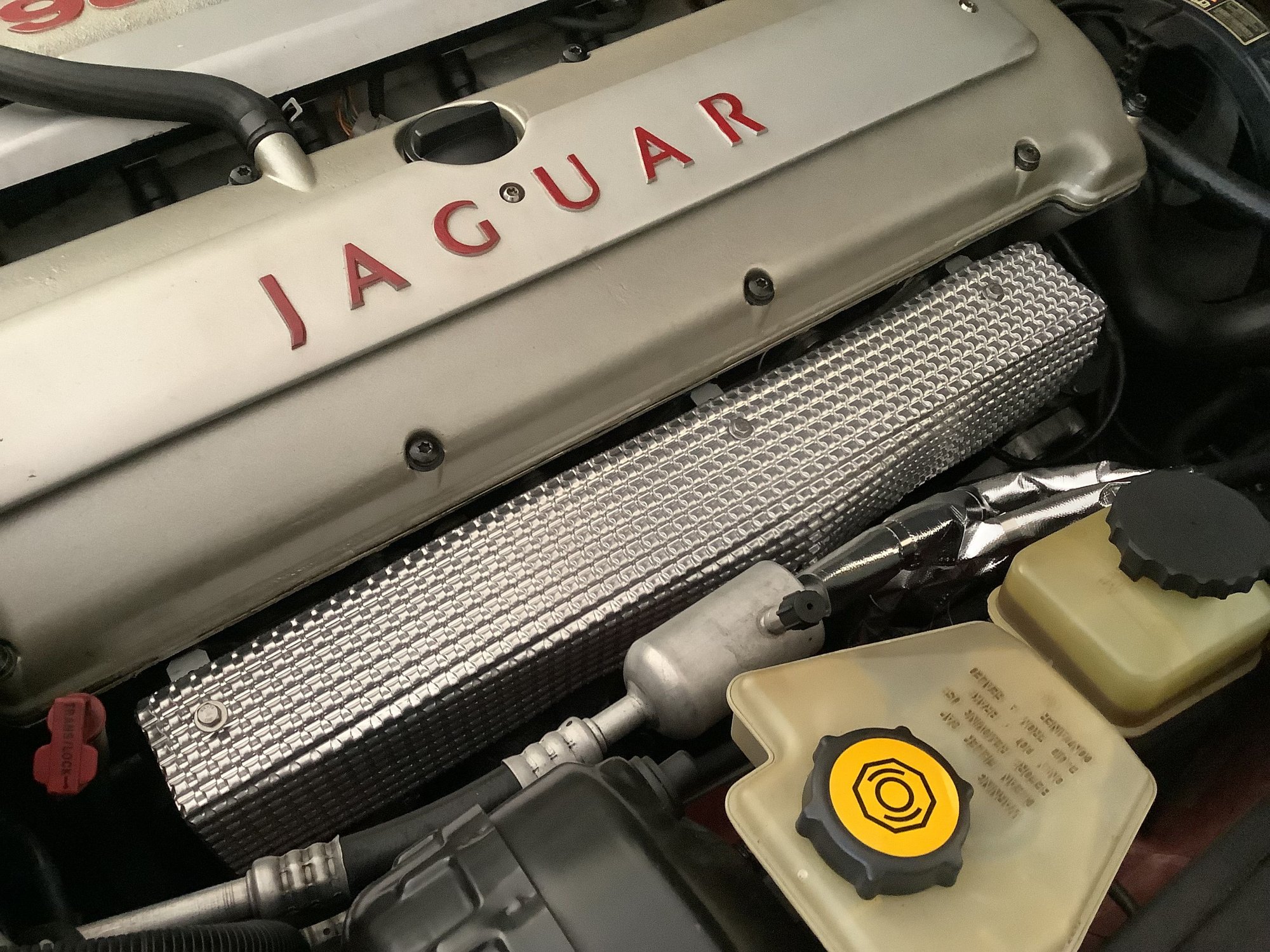

I also fitted lock nuts specifically designed for exhaust manifolds and fabricated a new heat shield, the original not fitting.

Very good questions, but sadly I am not sure why.
I left the work to David Marks who is a very respected engineer and technical advisor to the JEC and does a lot of work with the JDHT, in fact it was his garage that turned the Daimler Corsica from a concept car (X300 convertible) into a drivable car, and restored their XJ40 estate.
https://www.davidmarksgarages.co.uk/...rcorsica_part1
So I am guessing he didn’t think it needed them. I did ask him to make a heat shield but he told me unless I was racing the car then the air gap was sufficient and I didn’t need one.
Yours looks great
