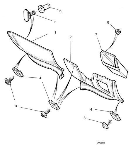

Don, As you said when I put it into recirculating mode the cold air on my knees disappears, how do I access the ducts so that I can duct tape them? Thankyou very much!
Old Mar 7, 2021 | 06:23 PM
Don B's Avatar
Posts: 20,503
Likes: 15,277
From: Crossroads of America
Hi Jagguyx300,
To access the ducts, you have to remove the knee bolsters/underscuttles and you may have to remove or displace other components. The underscuttles are attached with a couple of screws and fir tree press fasteners:
