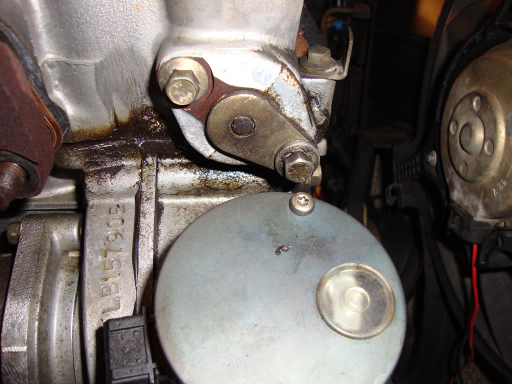

timing chain!!
upper tensioner to be exact

There was a TSB 03-1-09 issued 5-96 to address this fault . A revised tensioner is offered to replace the older one. New tensioner part # NBC2031AA but you need a shorter bolt to replace the longer one in the old tensioner. A new 'o'ring and gasket should be installed with the new tensioner.

I knew just because it seems to be a common thing that creates the tell-tale rattle, & the TSB that was issued to address this particular problem.
&it's easy enough to do yourself, but the cam sensor has to come out to give you enough room to get the old tensioner out.
motor has to be set at top dead center& once you have the tensioner out, double check that the camshafts are at TDC with the little jag timing tool.
reinstall new tensioner with gasket/o-ring and reinstall cam sensor and cam cover & ensure proper cam sensor setting and that's all there is to it.
but in answer to your original question, yes, your regular mechanic should be able to handle it if he's familiar with these vehicles.

Yes change the upper tensioner if yours looks like the 1 panchostatus posted. Also do not run lighter weight oil in this engine than 20-50w itll do the same thing

Matt, different engine, and not as criticle as the early v8's. Still should be done, but be prepared for not all the noise to be gone. You may need to have all the chains, guides and tensioners replaced. But that upper one is a easy quick fix, you just have to take out the cam sensor(in the spot once occupied by a distributor right below it. Make sure you mark the before dot location in relation to the body, and as you pull it up it will rotate since its a beveled gear. Mark were it goes to, this is where you place the dot to start installation, then the dot should be in the same location you started in with the body in the same place on the engine too.
