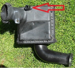

Took a while to find a picture of the bottom of the filter housing:
If it's the stubby outlet arrowed in red, it's at the lowest point of the housing and is presumably there as a drain.....?

Strange that, mine had that one blocked off, from factory! I remember, because I was wondering why on earth would they put there in first place, if they blocked it off anyway...

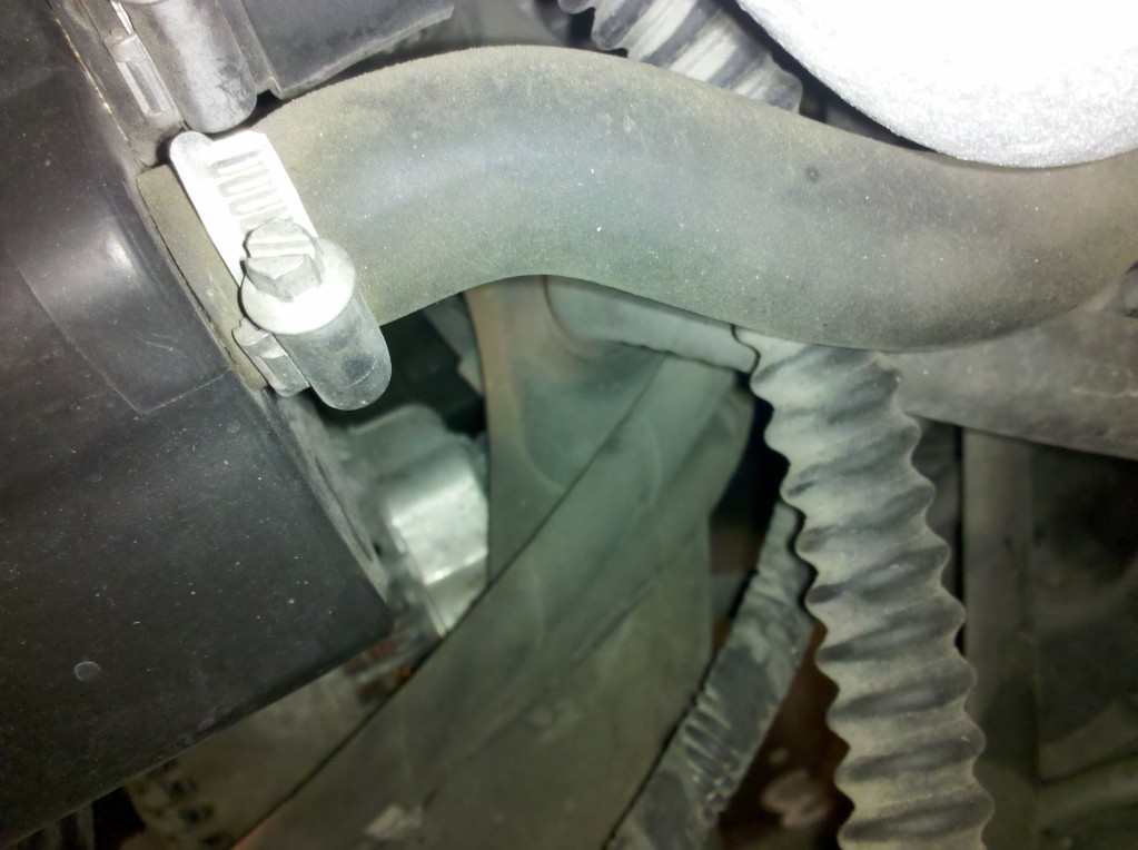

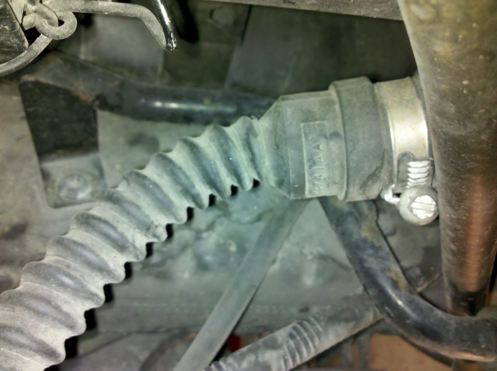

with the hose:
as stated, the other end goes to the air pump:
Attached Thumbnails Strange air pipe-img_20130814_194845_zps190fb624.jpg   Strange air pipe-img_20130814_194855_zpsbc311f43.jpg
