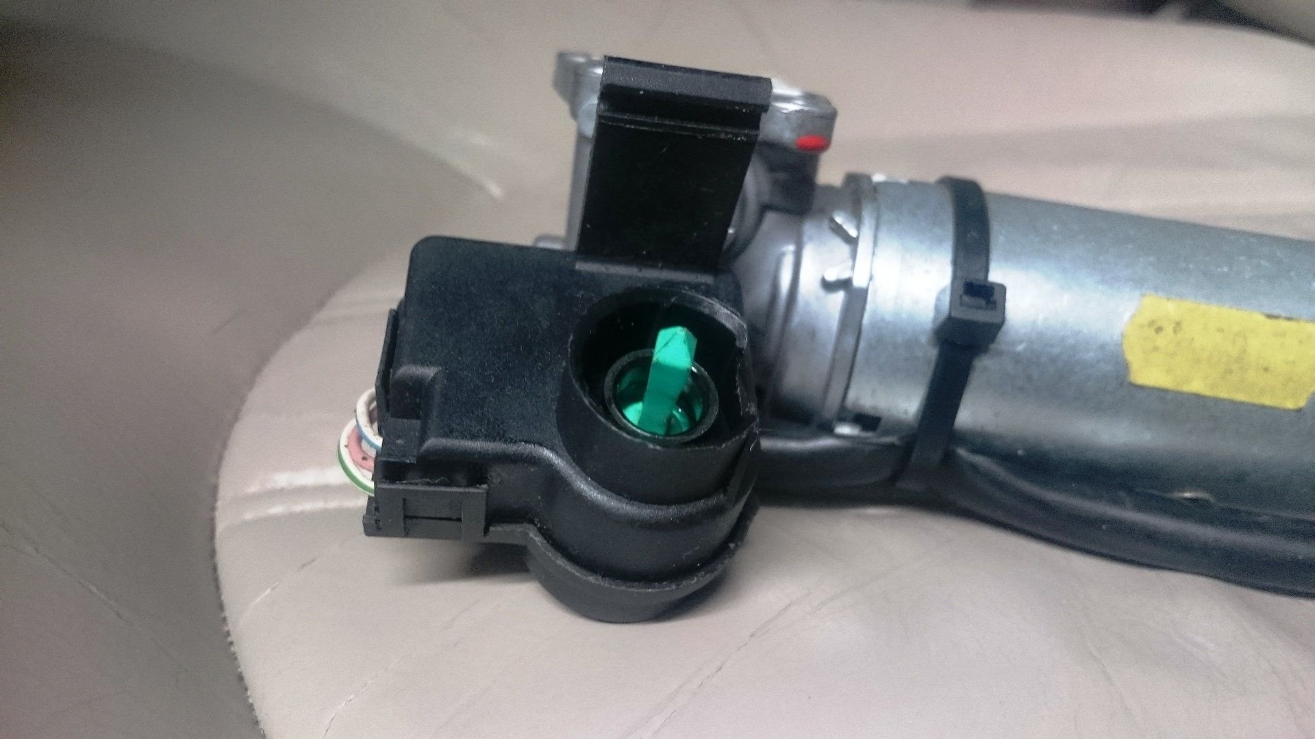

The motor on the bottom side has a sensor package that clips on with a big tang / tab , it just clips off
This sensor package has gears inside where the grease drags down the motor
You can clean the sensor package and give it a try
the package needs to be clocked when you put it back on the motor
you can drive the motor with a battery charger back and forth with the terminal tangs
This is a high current connection so caution and you might make pigtails to bring the final connection out from under there
It's the black square , many parts to fly everywhere
otherwise there is a TSB on upsizing the motor part # JLM 20194
10-12 (jagrepair.com)
