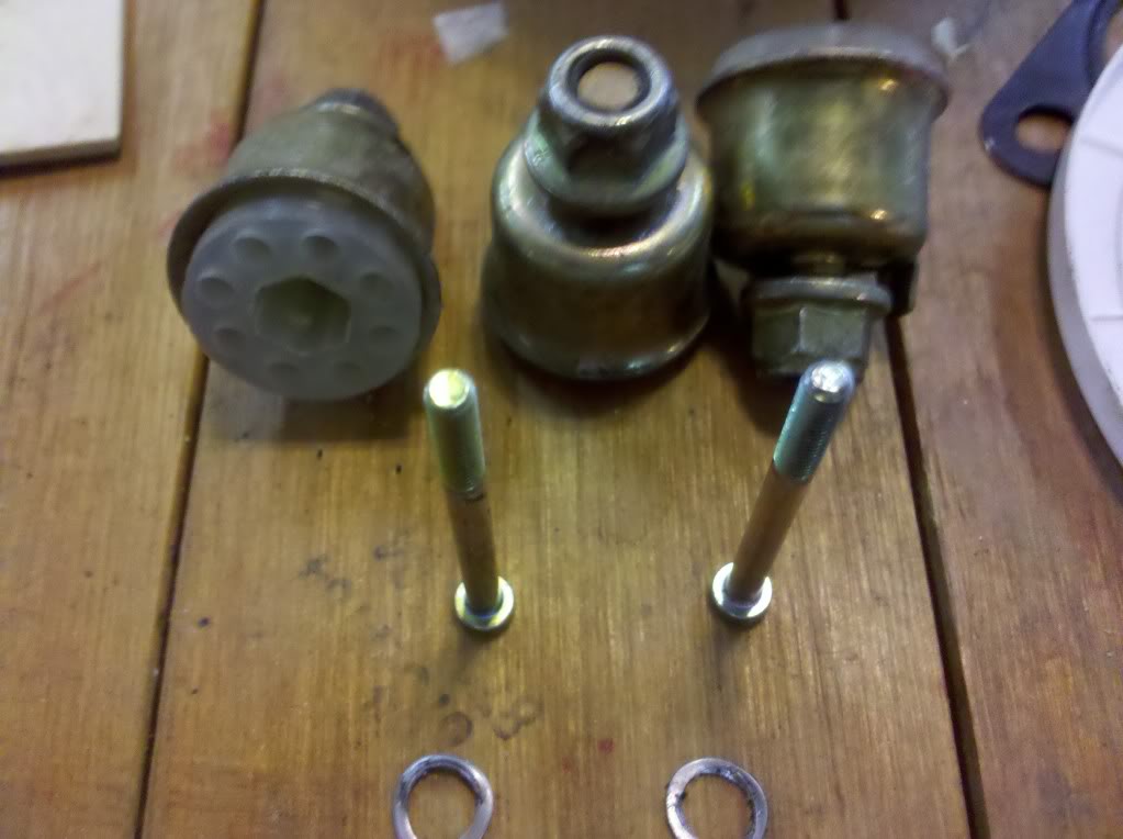

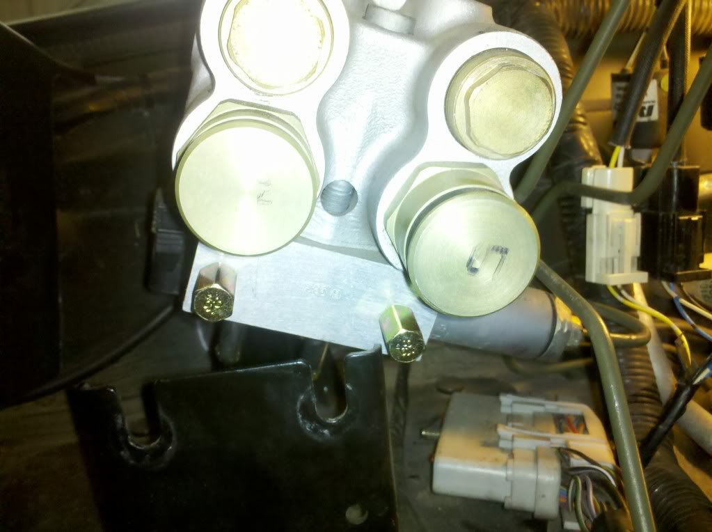

It's actually a bit simpler than RJ described, even. I think it's 3, but maybe only 2 iso-mounts holding the pump/valve/module on. Loosen those, then roll the whole asy up, forward and toward the center of the engine bay - yes you will be bending a bunch of brake lines as you do this...just keep an eye out that you aren't "kinking" any, just widening out their radii a bit. When you reach a certain point, you will have tool access to the lone fastener on the bottom that fixes the module to the valve-body. (Disconnect the electrical connector at the beginning of this process) I'm sorry I don't recall if it is an allen, torx, phillips or hex....I'll try to research my pics later this evening and see if I can come up with it.
Bottom line, I dreaded doing it needlessly - It was really one of the easiest fixes I've ever actioned on this car. I just wasn't too keen on bending that neat mess of spaghetti-like brake lines....but once you do it, you see it is FAR preferrable to disconnecting them all and having to bleed the system!
Edit:
Oops! Two fasteners! not one. The three bell-shaped jobs are the isomounts you need to loosen to get the whole asy freed-up:
They fit over the little brass hexes, 2 in front and one on the back:
Attached Thumbnails Weather cooling down and intermittent abs light back...-img_20110924_184200.jpg   Weather cooling down and intermittent abs light back...-img_20110924_184107.jpg
