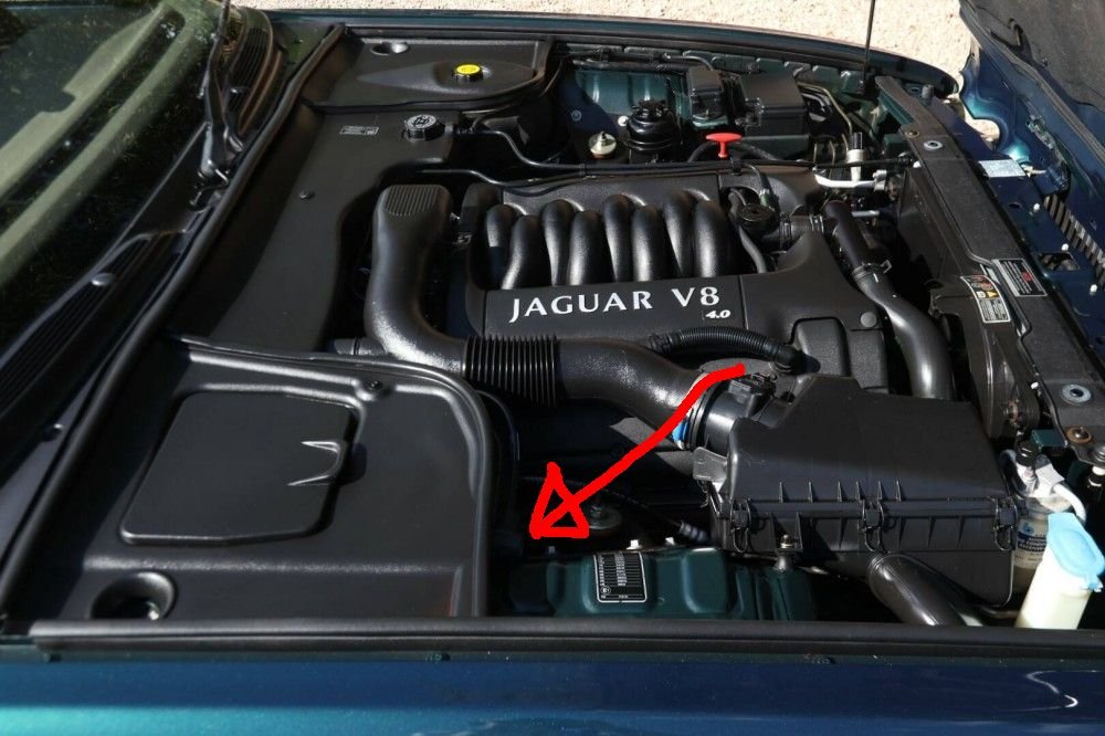

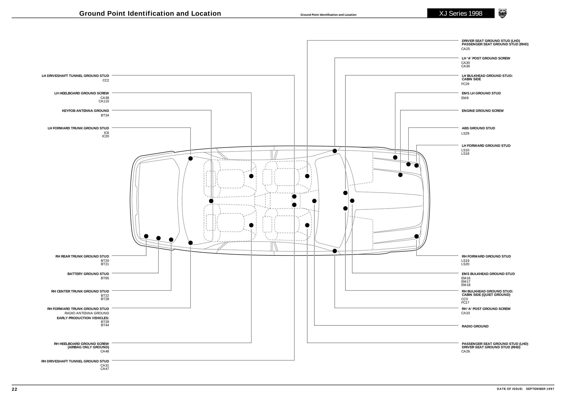

For starters look here, this nut must have to be clean and tight
check all ground points
and get the scanner, you will need it anyway
File Type: pdf
