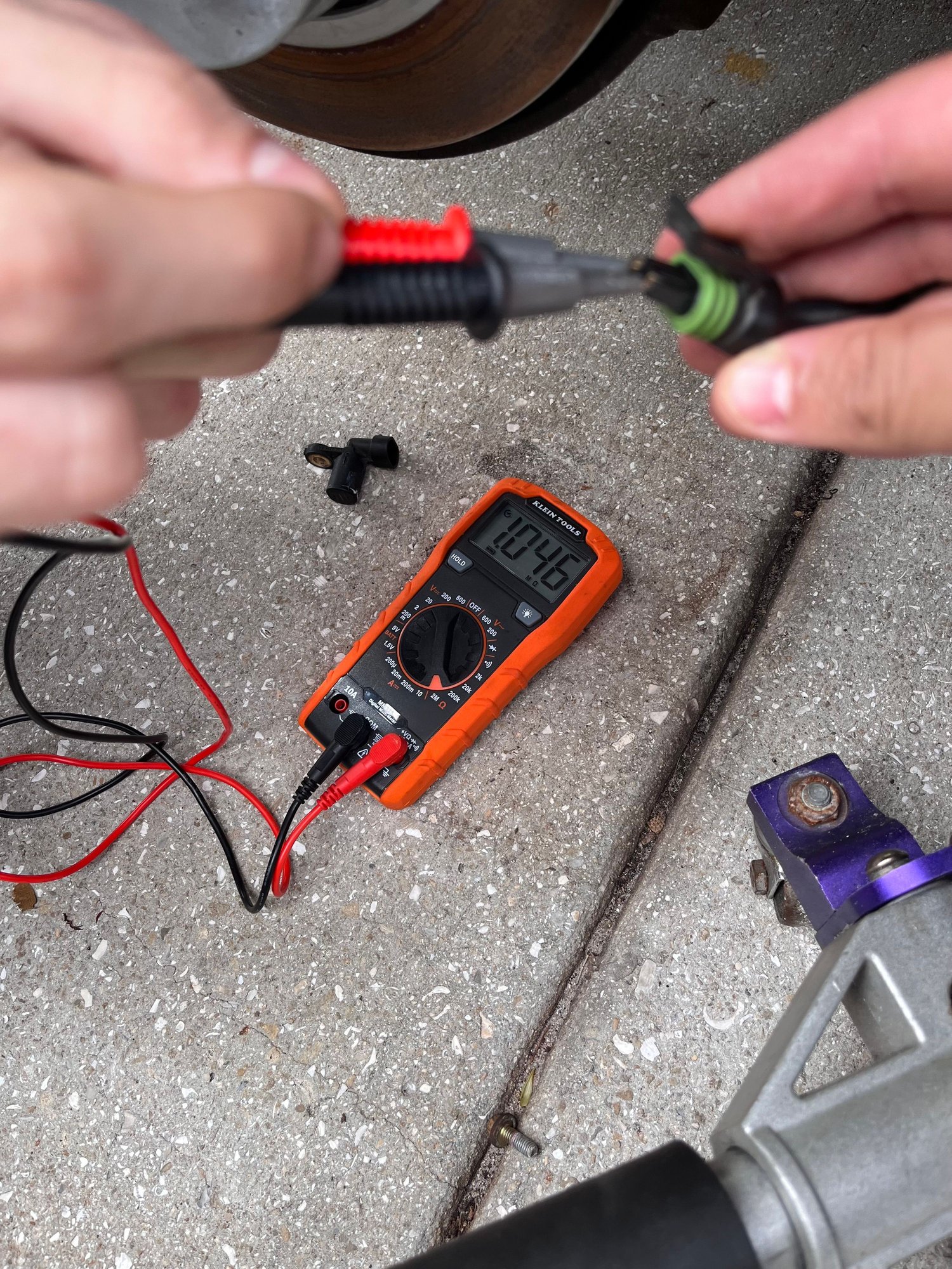

Old Oct 19, 2024 | 01:01 PM
Ant305's Avatar
Joined: Apr 2024
Posts: 125
From: SW Florida
I would inspect the rear link harnesses for continuity.
Wheel Speed Sensors RARELY fail.(unless the wheel bearings fail and physically damage the sensors or reluctor wheel/rotor)
These are the reading I got back
The first two photos is the driver side harness. It showed 2 different ohms when switched, I don’t know if that means something (im terrible with electrical)
Third photo is of the actual sensor.
0.550
1.045
0.001
The sensors seemed dirty so I cleaned them but did nothing to help.
Passenger side
0.553
1.046
.001
Are these within range or are they off?
