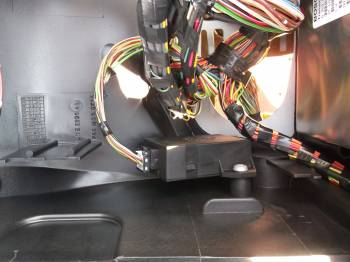

Old Jul 6, 2013 | 04:40 PM
flay's Avatar
Posts: 365
Likes: 71
From: Romania
It's in the ECU box, under the bonnet, right part, behind the bulkhead, a small black plastic box.

Old Jul 7, 2013 | 02:18 AM
flay's Avatar
Posts: 365
Likes: 71
From: Romania
Some pictures may help.
You must have the right windscreen also, with a black screen and a one inch diameter hole, to glue the sensor (if you have the simple glass, you can make the black part from some glass tint foil). You can use some transparent silicone sealant for the sensor.
I have all these factory fitted but still auto wipers don't work.

Old Jul 7, 2013 | 07:54 PM
coastaljag98's Avatar
Posts: 546
Likes: 45
From: Apalachicola Florida
Evidently it's not fitted because I don't have a module or even the plug coming from the wiring harness. So guess I'm not gonna have them lol.
