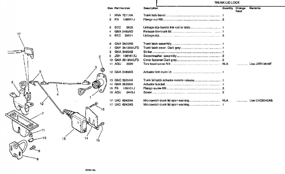

Hi All,
I located the earlier post with this attached diagram. It indicates I may not have to cut a hole? If I do it's no loss as the trunk lid is destroyed already. Thanks for the help.

Just drill a hole big enough to put the screwdriver shaft in
There are better pics coming as I did it myself
You will be moving the lever to the car's right so the screwdriver handle goes to the left
