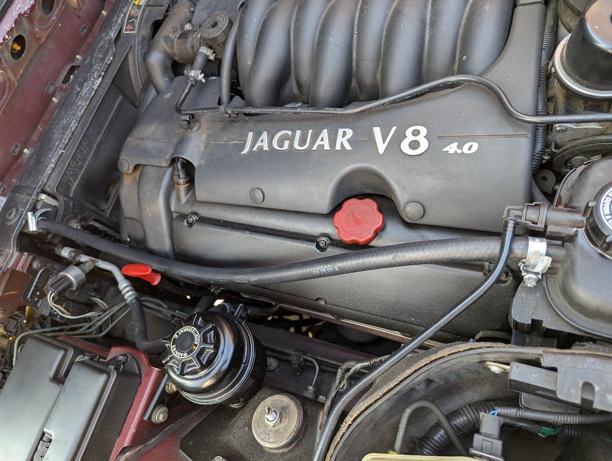

I am curious about this too... I just killed my second one of these damn lines while working on the pulleys. They are awfully brittle and stupidly designed imo. Also, I apparently bought the last replacement set whenever I broke these the first time and now I can't find any anymore in my entire country so that's fun.
I suppose I'll just replace it with some hose and a hoseclamp. Should work in theory. I'll report back with measurements once done.

The main difference is that a rubber coolant line is easy to replace with any generic hose and a clamp while this very specific piece of plastic with it's weird clip structure is very hard to get by. But I'm sure Jaguar engineers didn't have me in mind working on this car 26 years down the road

I replaced my broken line with a rubber hose. Real easy. 13mm inner diameter hose is a nice snug fit. Around 100cm length is enough. You Americans can inchify that for yourselves Seems to hold up well without leaks so far.

sort of looks light my field surgery on my 2001 back in 2013 after resting my hand on the radiator end: 6 inches and a hose clamp on the old pipe remnant and the radiator tit. I still have that piece in my tool box just in case.
Told this story before: I buy a new one from my local Jag dealer (had yet to hear about Rock Auto, et al), install the new. After changing out the secondary tensioners, water pump, TST and tower, stubby hose, cross over and temp sensor, and belt and belt tensioner, I take the car to Checkered Flag Jaguar for a one year service (oil and filter change, fuel filter, kiss and a promise -- whatever they do for $200). Looking the car over after getting it home, I noticed that my new hose is different. I had removed the taped on paper part tag on the one I installed, this one had the tag. Goes to show you, even the pros sometimes rest their paws on the wrong place . . .
