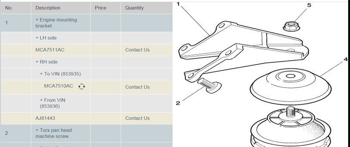

Looks like these engine mounting brackets might be the ones you need??
Jim Lombardi
Attached Thumbnails Can someone explain what this engine part does?-jaguar-x308-engine-mounting-bracket.jpg

As I said earlier, I had exactly the same symptoms as you have, where the breather pipe comes off after heavy braking and a "clunk". The parts I replaced, to cure this problem, were the 'V' mounts. The part number for these is MNC 2360 AB, and of course you need two.
As stated earlier, you can check the condition of the 'V' mounts very easily to see if they have become de-laminated. You could change the engine mounts as Jim suggested, but as your symptoms are exactly the same as mine were I would go for the 'V' mounts.
