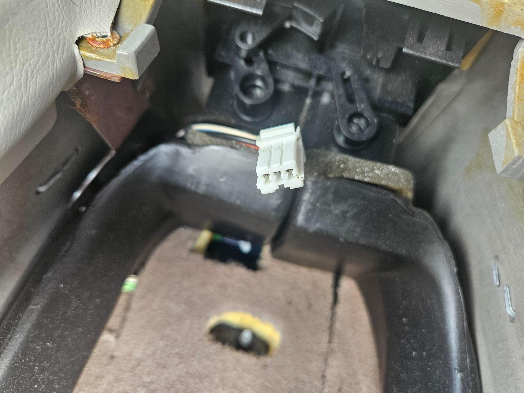

Hey Nilanium, I just opened up the center console and it DOES have the wiring for the VPD rear vents. I'd absolutely buy the vent/socket piece off you.
Feel free to PM me to exchange details.
The connector I can only assume is the cigar lighter connector for the VPD trimp rear vent.

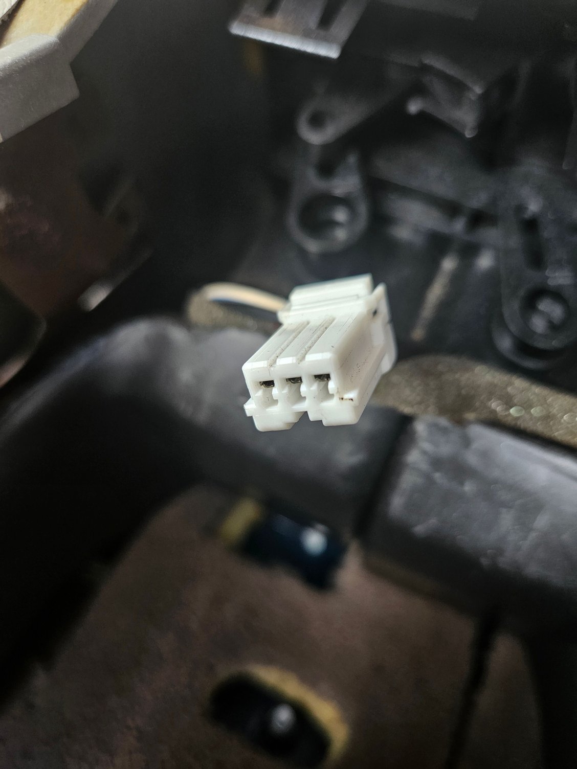

Easy enough to pull the console cubby insert and look at the harnesses at rear climate vent.
Remove the lid and cubby box fasteners, lift it out.
Should be +,- and illumination wires.
Thanks for the idea motorcarman! It was super simple, I added an aftermarket cigarette lighter in the cubby, and it looks perfect. I may post pictures later.
For everyone else's knowledge, there is a 3 wire connector (see below) that is negative (black), positive (grey/green), and a high gauge illumination wire (red). I confirmed that the red and grey/green are only active when the accessory or ignition is on.
Really easy job, and I can still replace the rear vent assembly afterwards.
