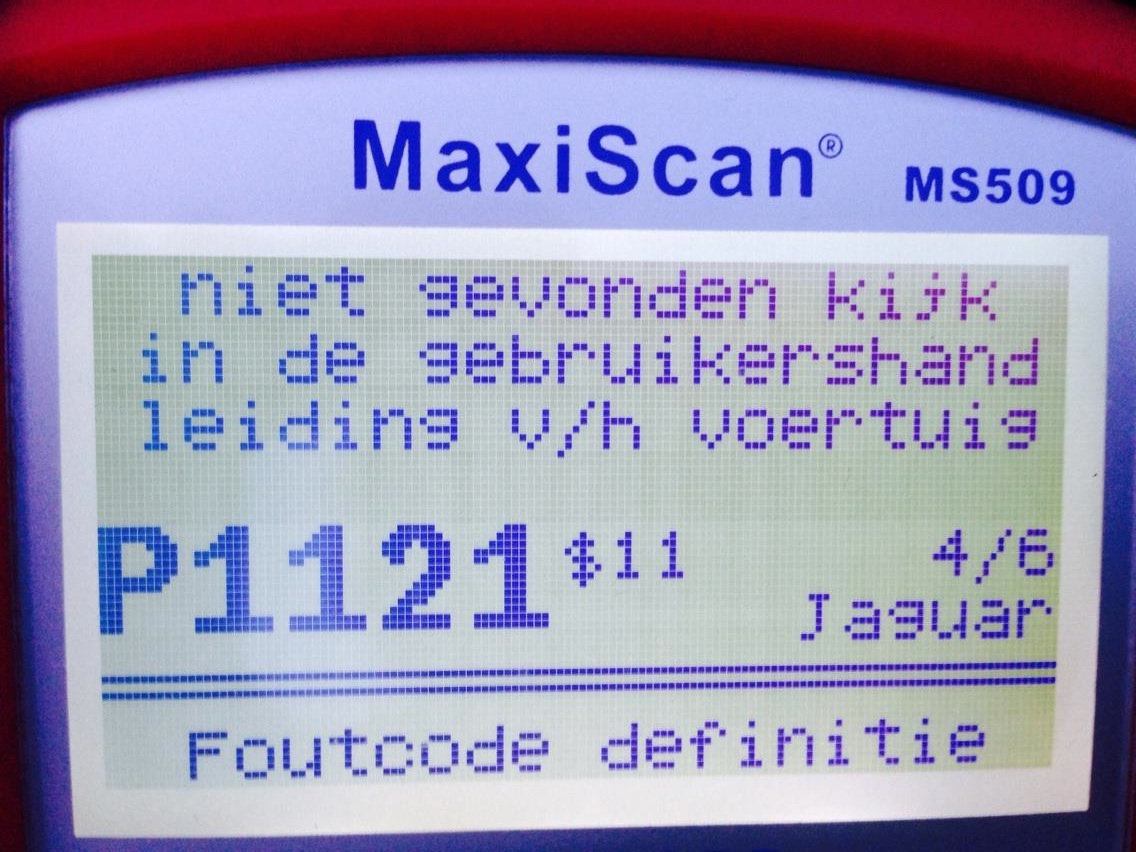

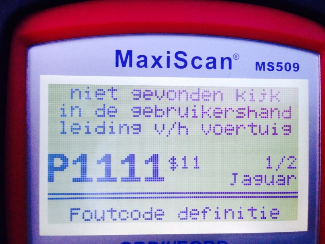

Just plugged in my OBDII reader Autel Maxiscan MS509 for the first time .
Its in Dutch language, but 6+2 codes are there.
I have no idea whats the list of codes means
But i try to search the forum also..
I have 8 codes ,and the car has ABS/TRAC light most of the time
When i start or drive the car.
And sometimes goes away when the car gets in second gear.
If it takes to Long to get into second gear the light also comes on.
A bump in the road or waiting in front of a Traffic light and the ABS/TRAC Comes on again ..
Also have had a few times restricted performance light after the engine mount broke .
Also a fuel smell somtimes and i cannot located where that comes from..
I have never seen that restricted performance light before the problems with The loose engine {the engine is tight now with new mounts}
I wanna have it fixed because it almost got me in allot danger when the Car Lost power on the freeway.
I have the codes here pictured
Sorry for the Dutch language on the pictures.
Can you guys please help me in the right Direction what could be the
Problems, think there are a few...

Roy,
p0105
Map sensor likely unplugged, check the little plastic tube is connected.
p0400
EGR valve issue, not plugged in? it connects to the lh exhaust manifold, it could have a leak...
p0430
catalyst below threshold - is it plugged in? B bank 2 h20s sensor
p1121
Here we go, this is a common fault now with the throttle position sensor wearing out, it has 2 tracks that are in constant contact with the ECM once the tracks wear, signal is lost and restricted performance activated. Since it didn't occur pre-wobbly engine check the connections before sending away to ASI for a rebuild, a new throttle is $2000, the part can be bought but second hand and prone to failure also.
p1601 I've no record for
p1646
fuel pump 2 relay malfunction - could be a failure, swap the relays to check or use a spare.
I think you've replaced the battery recently?
Of the codes above the only one that bothers me is the 1121 as it's a random bugger and not funny when it happens.
The rest, well ask the guy who fitted the engine mounts/subframe bushes to go over the connections.
Clear the codes once this work is carried out above to address each and see if they come back.
P1111 is a 'nothing code' the scan cannot complete because of the codes, when all is well this code turns to P1000 - all clear scan pass. We always have 1 code 1000 if there's no issues!
hope this helps, it's a sister car treat it well!

[QUOTE=
hope this helps, it's a sister car treat it well![/QUOTE]
No Sean, you just reversed it. P1111 tests complete.

Thank you very much Sean for input .
The MAF sensor connector was pulled of the MAF two times because of the broken Subframe mounts .
The engine moved to much and pulled of the MAF connector
After this i got all these random Restricted performance light and power loss car goes into limp mode ,when restart a few times it solves again.
I hope it didn,t brake a internal wire somewhere ,
And i will check again and clean the connector ,the connector clicks in the MAF and i plugged it in a few times maybe of the pins are bend and make bad contact i will check...
The MAP sensor ,when i locate it i will check the connections and vacuum hose .
Hope i find loose connections or hoses ,that would make it easy..
I wil check for the fuel pump relais in the trunk ,and switch them .
And see what happens.
And the TB sensor,worst case i try to get a second hand TB with low mileage And than i can send other the TB for repair ,i need my car...
Could it be a TB plug connection problem ?,can i pull the plugs on the TB And Check the pins without problems?

Just read the codes after several Limp mode,s .
P0102 MAF G70 Signal to Low
P0105 Sensor manifold /atmospheric pressure-G71 /F96 Malfunction
P0112 Temperature sensor For intake air G42 signal to low
P0332 knock sensor 2 -G66 Signal to low
P0400 EGR system Malfunction
P0430 Cilinder bank 2 cats system efficiency under threshold value
P1121 Code not found
P1642 Code not found
P1646 Code not found
P1601 Code not found
ACTIVE CODES
P1111 Code not found
Need help..
