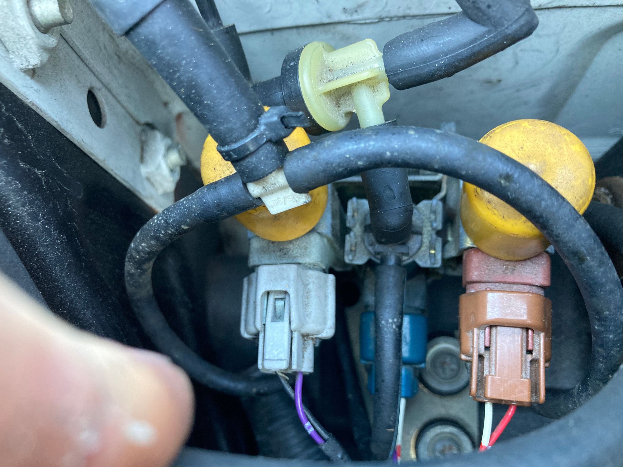

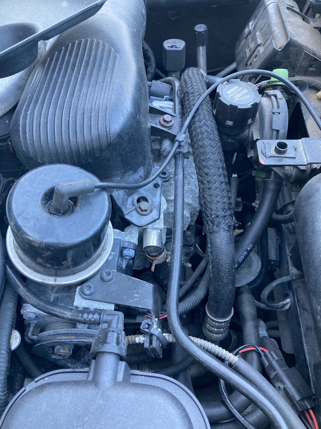

Are you talking about a vacuum leak from this canister?
Or a leak from these valves? Or the vacuum reservoir under the air cleaner?
The last post you made about the CC, were you talking about these yellow caps on top of the valves that are loose? If so, those loose fitting caps are there to prevent dust/dirt from entering the inside of those valves. Those valves are there to bleed off and hold vacuum that’s being applied to the vacuum canister on the TB.
Old Apr 1, 2021 | 08:37 PM
3timejag's Avatar
Joined: Apr 2015
Posts: 480
Likes: 19
From: Jacksonville, Fl
Hey buddy, I’ll call you next week.
is there supposed to be a “sucking/ vacuum leak” type sound coming from that area?
Old Apr 1, 2021 | 08:54 PM
Addicted2boost's Avatar
Posts: 3,125
Likes: 1,280
Which area specifically?
Old Apr 1, 2021 | 09:09 PM
3timejag's Avatar
Joined: Apr 2015
Posts: 480
Likes: 19
Sounds like from the solenoid cylinders. The little hoses all “look” good to me, no cracks that I ca
n see.
Old Apr 1, 2021 | 09:10 PM
3timejag's Avatar
Joined: Apr 2015
Posts: 480
Likes: 19
The hissing or sucking noises fucuate when I move the cylinders back and forth
