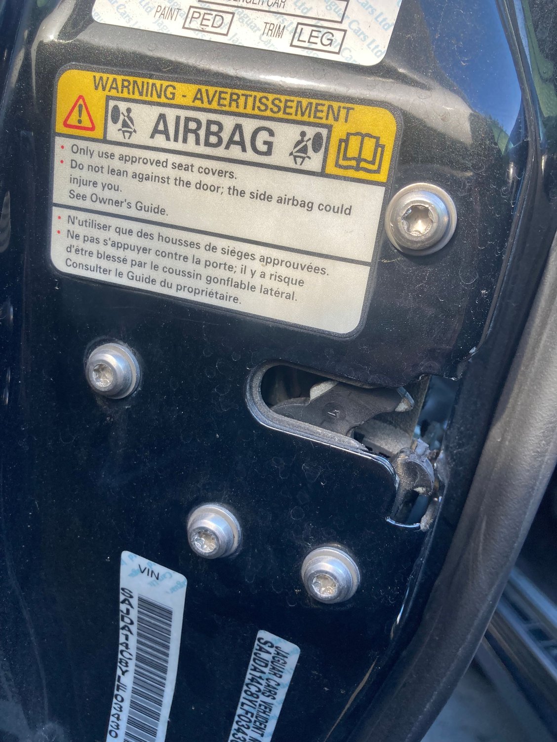

I get what you mean, I have removed the door panel and the door control module to see if I could reach in there and pull it out, but there's part of the metal frame right over where the actuator is. The only way I see in is removing that door latch, as it seems to all be connected. Once I remove the four bolts on the side I should be able to pull on the entire assembly towards the inner part of the frame so I can access the actuator.
The four bolts I'm talking about.
I'm not entirely sure, but like I said, I should be able to push the assembly inwards from this area, towards the middle of the door and grab the motor.

That far left bolt holds the window channel in place. Maybe search on this forum for a write up before tackling removal of the lock assembly. I’d still stick with lubricating everything while it’s still in the door to begin with.
