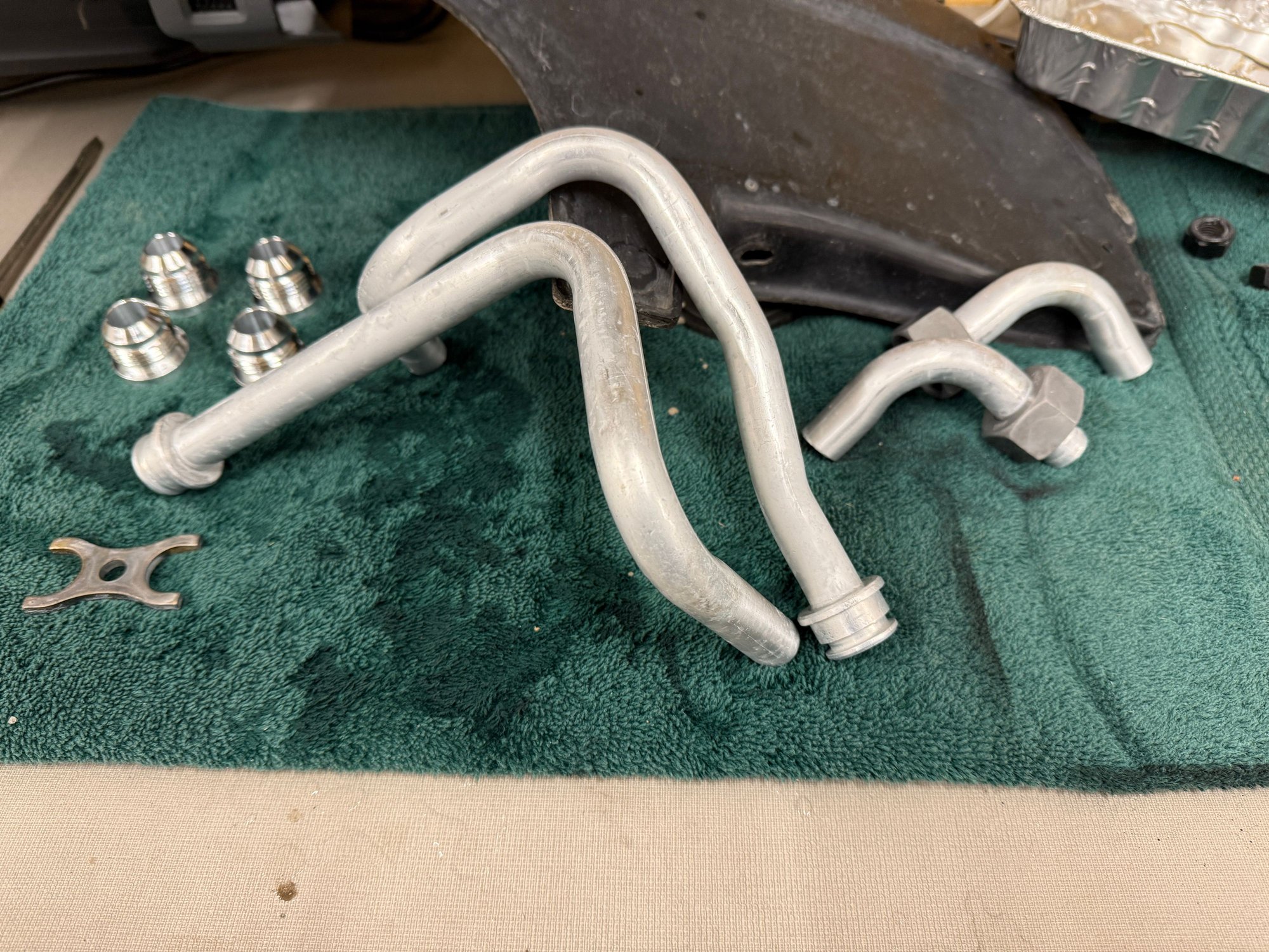

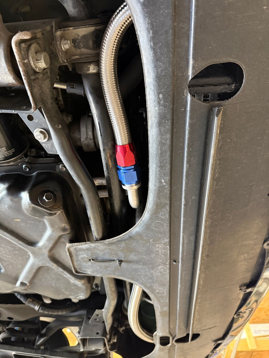

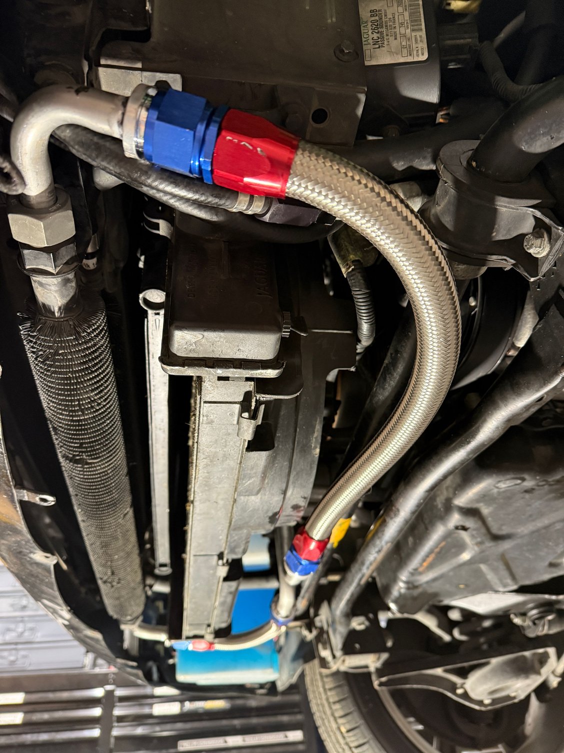

Project is done. My fittings came loose immediately and unthreaded by hand, so I didn’t need to remove the cooler itself. The car having spent most of its life in Nevada and Arizona no doubt helped me here!
I ended up cutting off the pipes and having 12AN male fittings tig welded on to the aluminum pipes. I bought female fittings and hydraulic hose and cut it to the lengths I needed, accounting for the fittings.
It turned out great. I recommend this if you can tig weld or can find someone skilled at it. Below are a few pictures. I ultrasonic cleaned the parts, scuffed the weld area, cleaned again, then cleaned with acetone, and took the pieces to the tig welder guy. I wanted to be sure the pieces were properly prepped because I hadn’t used this guy before so I wanted to be careful.
I'm glad a2b noticed this problem from a picture I had posted. The old hoses were completely shot. I feel better now!
