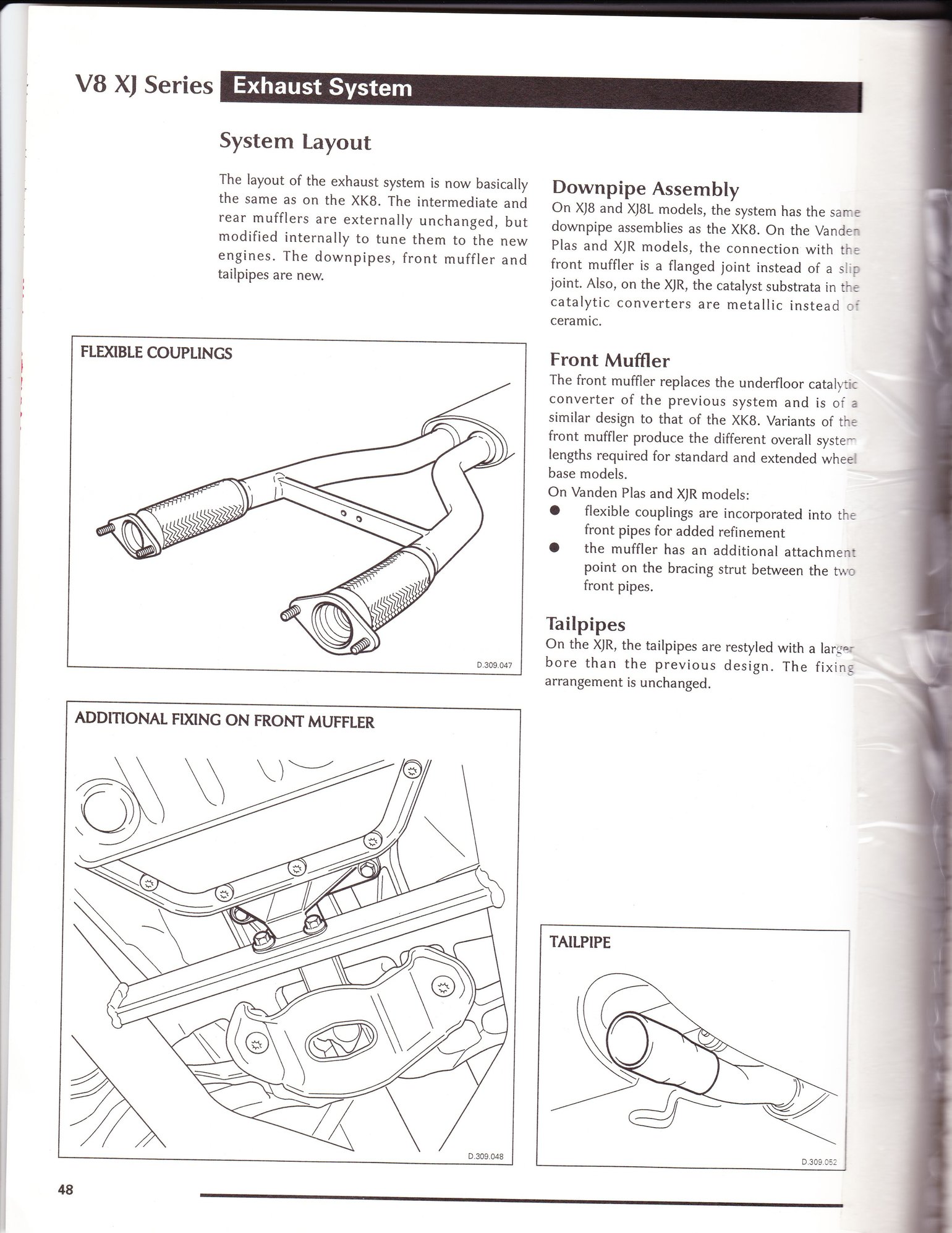

I remembered wrong, both the Vanden Plas and XJRs got the exhaust flex coupling, along with an extra attachment on the crossbrace.

That's from a hard copy of this PDF (page 48): http://www.jagrepair.com/images/Elec...jm18151280.pdf

That PDF is really handy to have, stashing that away in my saved jag files.
Guess I'll be going back to the junkyard for that exhaust then, I checked my muffler today and I'm suspecting internal failure, I didn't see any obvious holes, but more importantly I could cause a rattle by knocking on it with my hand.
