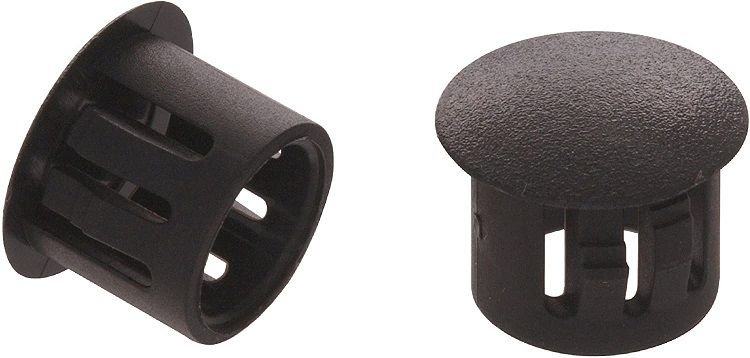

First, for the repair area...Use a hole plug, they come in 1/4", 3/8", 1/2" etc...they come in black or white primarily and can be found in the specialty parts bins of the big Orange box or bit Blue box, even Amazon, but those are usually in bulk. They have clip in wings for retention. Be sure the hole you made is drilled to size, roundness is important for these.
Then do as you state for the paint prep and spray. Take the plug and insert it, it will look like a factory plug and can be popped back out at anytime for any possible future latch issues. You may want to put a dab of silicone around head lip to prevent dust from getting in and to assist in holding it in place.

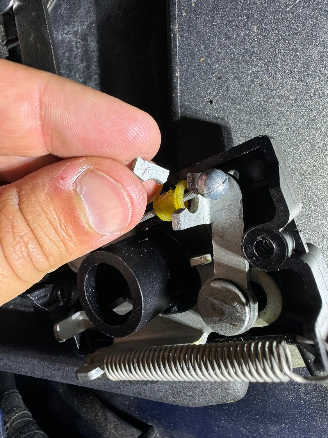

Word of caution ⛔️
In other posts users recommend to just use pliers to squeeze the lips to make it more difficult for the line to get out. I tried it and learned the hard way NOT to do it. The metal snapped.
Any other ideas like the one from RandyS on fixing it so we have no issues in the future?

About the only other thing to do is find a junkyard or eBay one.. HNC2400AC ..replace so you have a complete piece and tie down as RandyS shows, I did likewise years ago.
