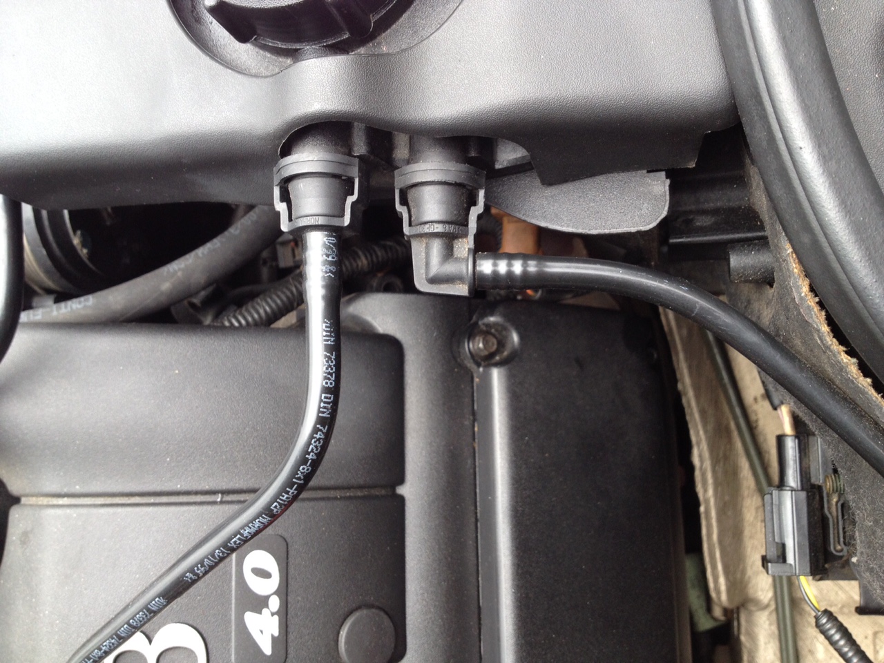

I too have experienced a very small drop in coolant requiring I add about 2 ounces per month. Your post regarding the proper connections for the coolant lines may have just solved my problem.
I have attached a picture. Hopefully you can use your familiarity with the X308 engine compartment to orient yourself. It appears to me that the connections are the opposite of what you stated as correct in your post.
Can you help me confirm that they are backwards? Also, would this account for my slight coolant loss? Also, will switching them correct my problems with no likely damage done thus far?
The engine was replaced just before I bought the car, so they've possibly been connected incorrectly since December 2014 (about 7,000 miles of driving). If I switch them back, should I have anything else to worry about regarding this?
Thanks much,
Jeff

They look the wrong way round to me. I'm pretty certain that there is a diagram somewhere on the forum if you search for it.

Yes, I responded as an excited impulse but I then proceeded to search. It DOES appear someone attached mine incorrectly.
I just went out and switched them. Those connectors will never win "Design of the year" because the threshold between what it takes to remove them and what it takes to break them is very thin! haha. Fortunately though, I did not break them.
So my only remaining concern is ; "did that cause any permanent damage?".
--- I thought I would share how I finally removed the connectors. I used snap ring pliers (external? the ones that open outward) and pulled gently while the pliers were expanding the fitting. They came off perfectly. In the future I will hopefully not experience any more frustration when working with this kind of connector.

H14: yep, from your photo they need to be swapped. I use long needle nose pliers to relieve pressure on the fittings (an aside, these cars were shipped with the tool tied somewhere around the radiator; dealer techs often forgot to put them back: I can't remember if it was Bob or brutal said they had a whole toolbox full of them). I don't think you have done any damage. I would buy an OBD two reader that will show engine temperature real time; keep connected as you drive and keep an eye on the temperature.
