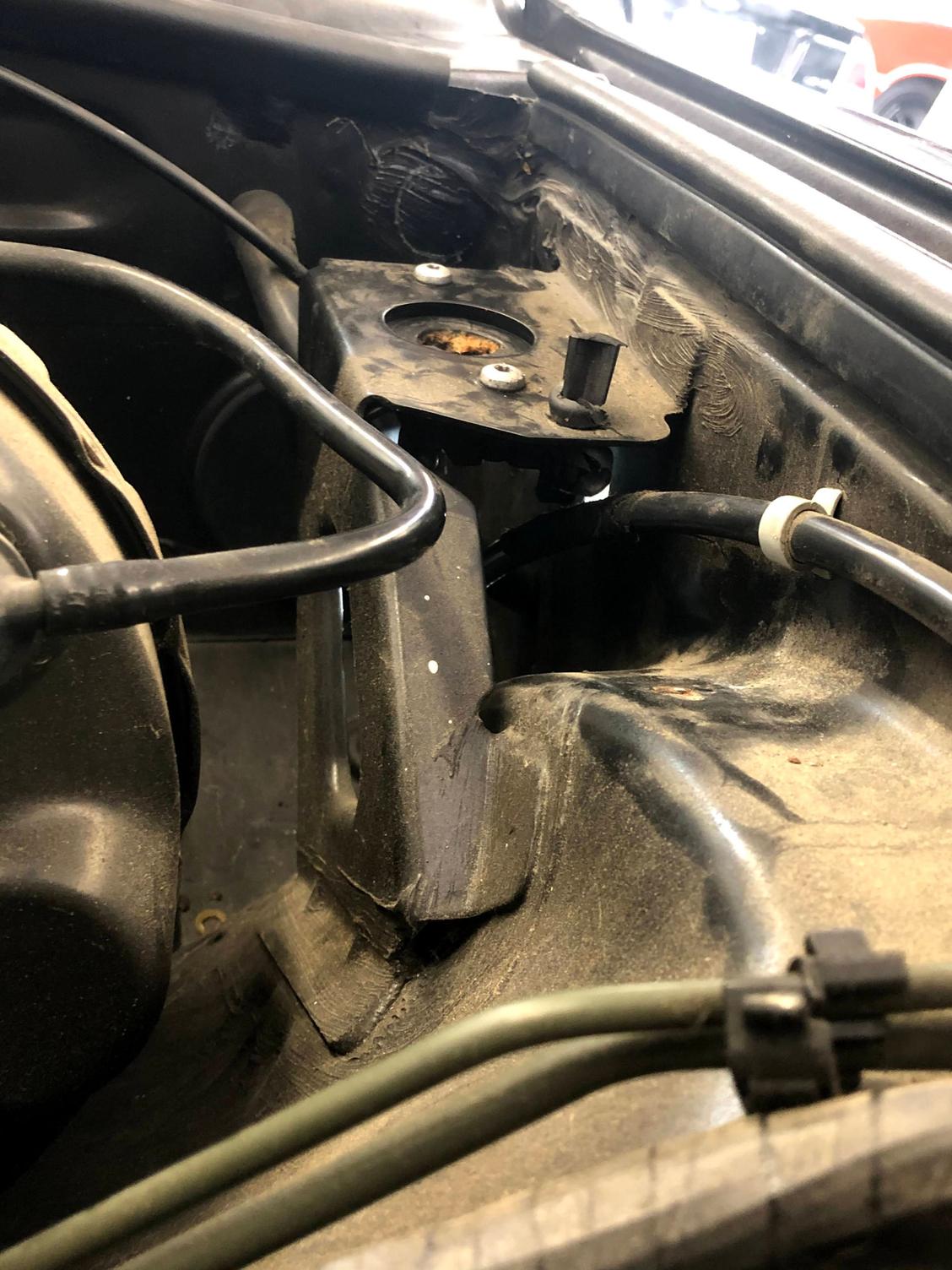

This is what you can see once you remove the wheel liner

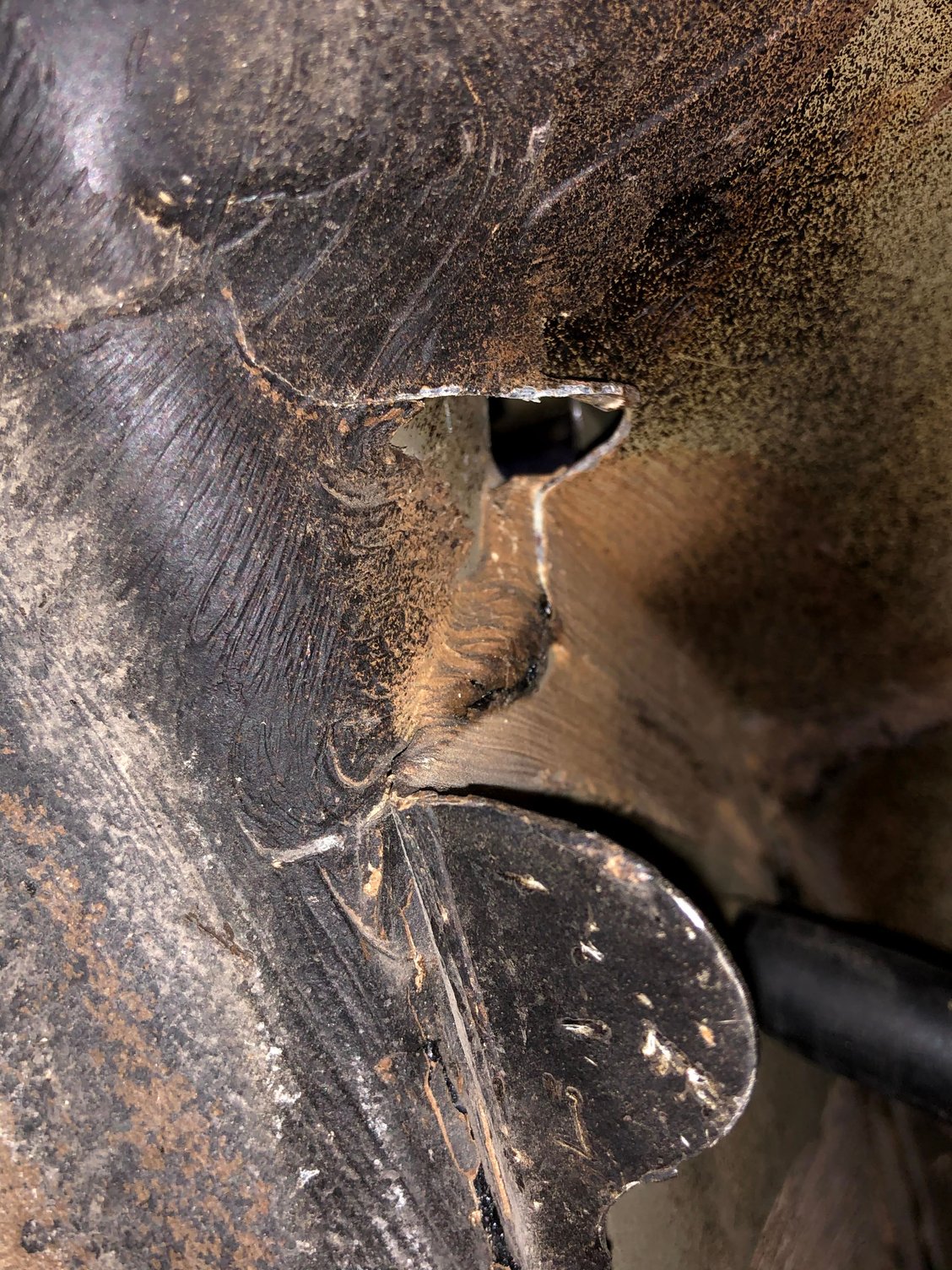

This tab you have to bend towards the outside of the vehicle a bit and there should be a hole right inside there. You can see the middle section of the hole in this photo
Here you can see light coming through the hole that you need to put the screwdriver through

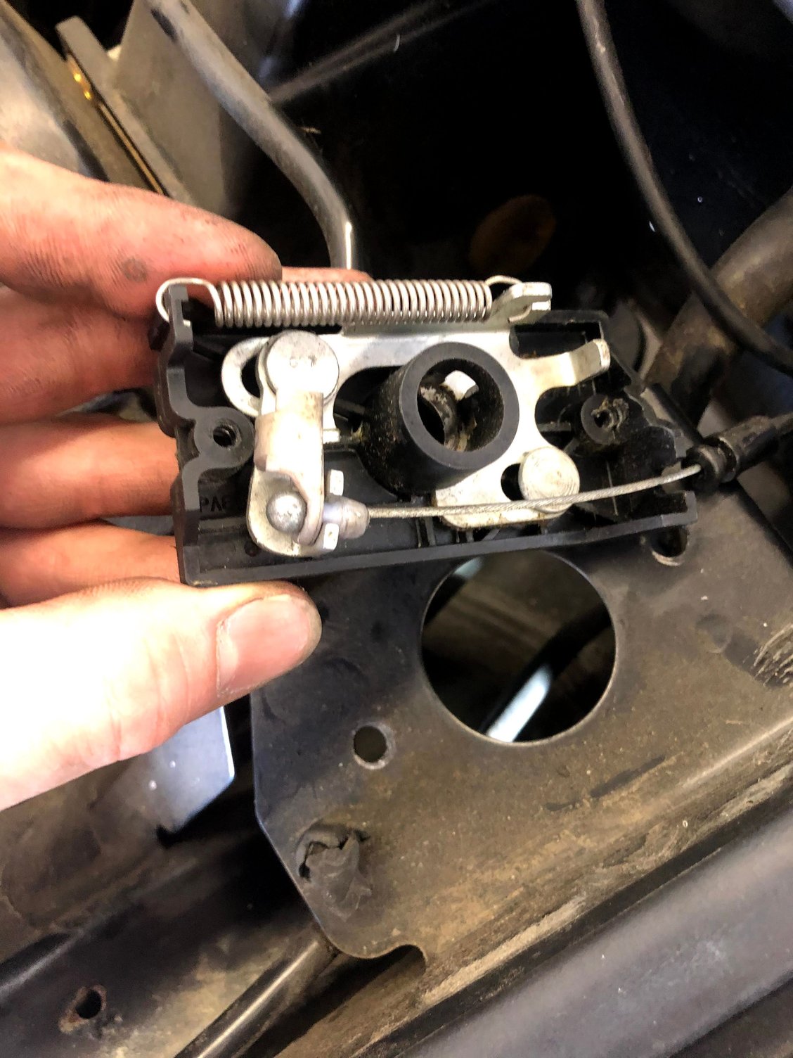

Here's a reference photo of the backside of the latch along with my fix. The silver part of this needs to be pushed towards the rear of the car
Here's my hood latch and the generic door cable clip that I used

Please help me understand Kroeker’s pictures here. Older thread, but I’m trying his technique. I see the half moon shaped tab, and I see the hole in mine where light is dining thru on his. Is that jagged looking hole the hole he’s talking about? Am I supposed to aim the screwdriver straight up to find the latch? How long of a screwdriver are we talking? I can get my screwdriver in the jagged looking hole and it strikes something but I don’t know how close I am, or at what angle I should strive for. Thanks all. Hoping not to drill but it may come to that.

Dang you should've waited a bit longer. But for future reference it's the jagged hole you go through and then there's another vertical hole after your screwdriver goes through the jagged hole.
I circled the second hole you go through hopefully for more clarity.

I found these grommets on Amazon. Fits perfect. I recommend doing this instead of squeezing the forks together, because mine broke when I tried to squeeze them. The size of the grommet says H-M4, whatever that means.
