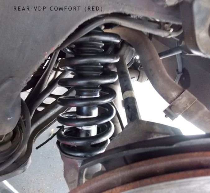

The comfort springs on my 2001 N/A VDP are coded red front and rear. (shocks are comfort black Bilsteins)

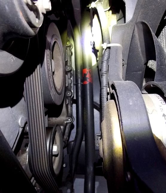

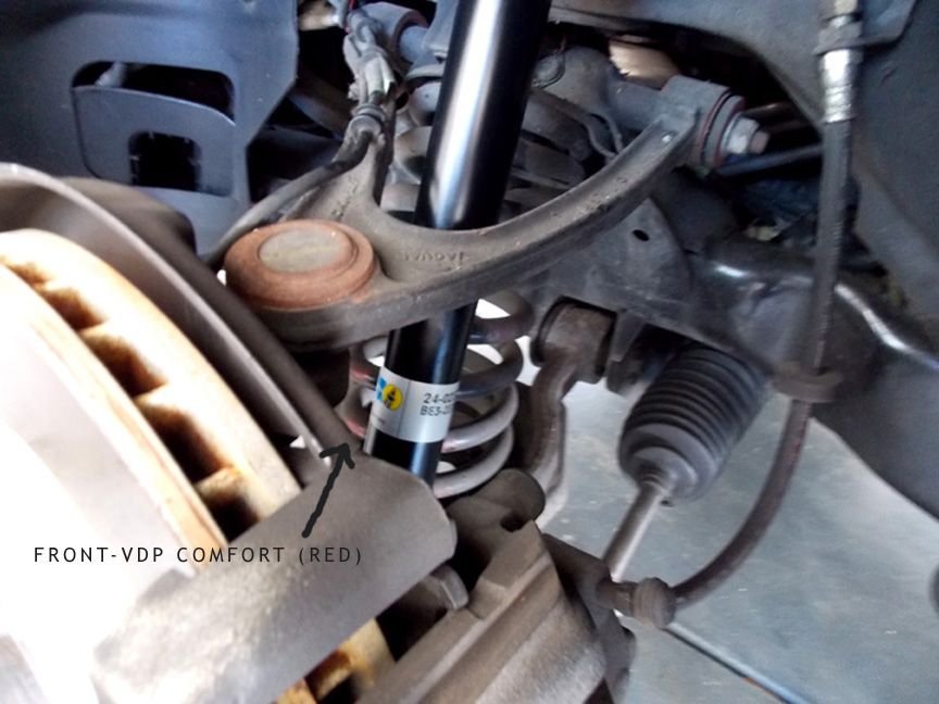

The comfort suspension sway/anti-roll bar (Vanden Plas) has a red color-code band (MNC210000AE)
The "standard" suspension sway/anti-roll bar (N/A XJ8) (MNC2100CF)....yellow color band I believe.
The Sport suspension sway/anti-roll bar (XJR) (MNC2100DE).........blue color band I believe.
Vanden Plas red color-coded front sway bar.
