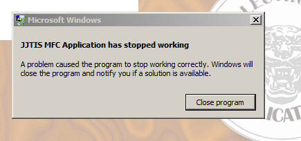

Installation worked, but whenever I try to click on any of the buttons at the top (except “NEW” or “HELP”), I get the following error:
I’m running Vista.
Any ideas on what I could try?
I’m running Vista.
