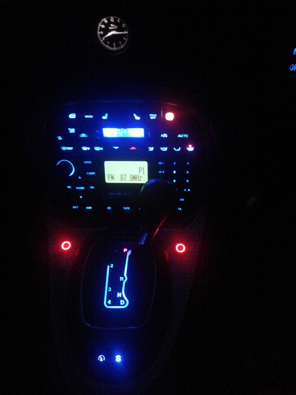

Centre console..

Bumping this thread for bulb info. I'm also looking for the "error free" type to avoid having to add resistors(I don't want the lingering glow from residual charge).
Just going to do the map,doors & rear reading/whites, then wait to tackle the difficult climate & cruise control bulbs.

The interior lights aren't on the can-bus, the exterior lights are.
The plug and play led's available now are already fitted with resistors, but they're for a 12V rail, all the interior backlighting is 5V if I remember, it's been a while
I found most of the twistlock led's worked fine when fitted but after a while they flickered or stopped working. This called for soldering and no lighting issues since. You'll see why I soldered them when you get a look at the skinny little wires the led bulbs are meant to contact don't do it very well.
Now, led lighting has come on since I did this conversion, maybe 6 years ago so I may look into the latest SMD LED's for certain jobs on the car.
I still get enjoyment out of the switch particularly at night when it looks the best, vivid and bright against the standard weary glow of incandescent bulbs - I think it suits a dark interior. I also added backlit door pulls and footwell lighting, it gives the car more energy.
