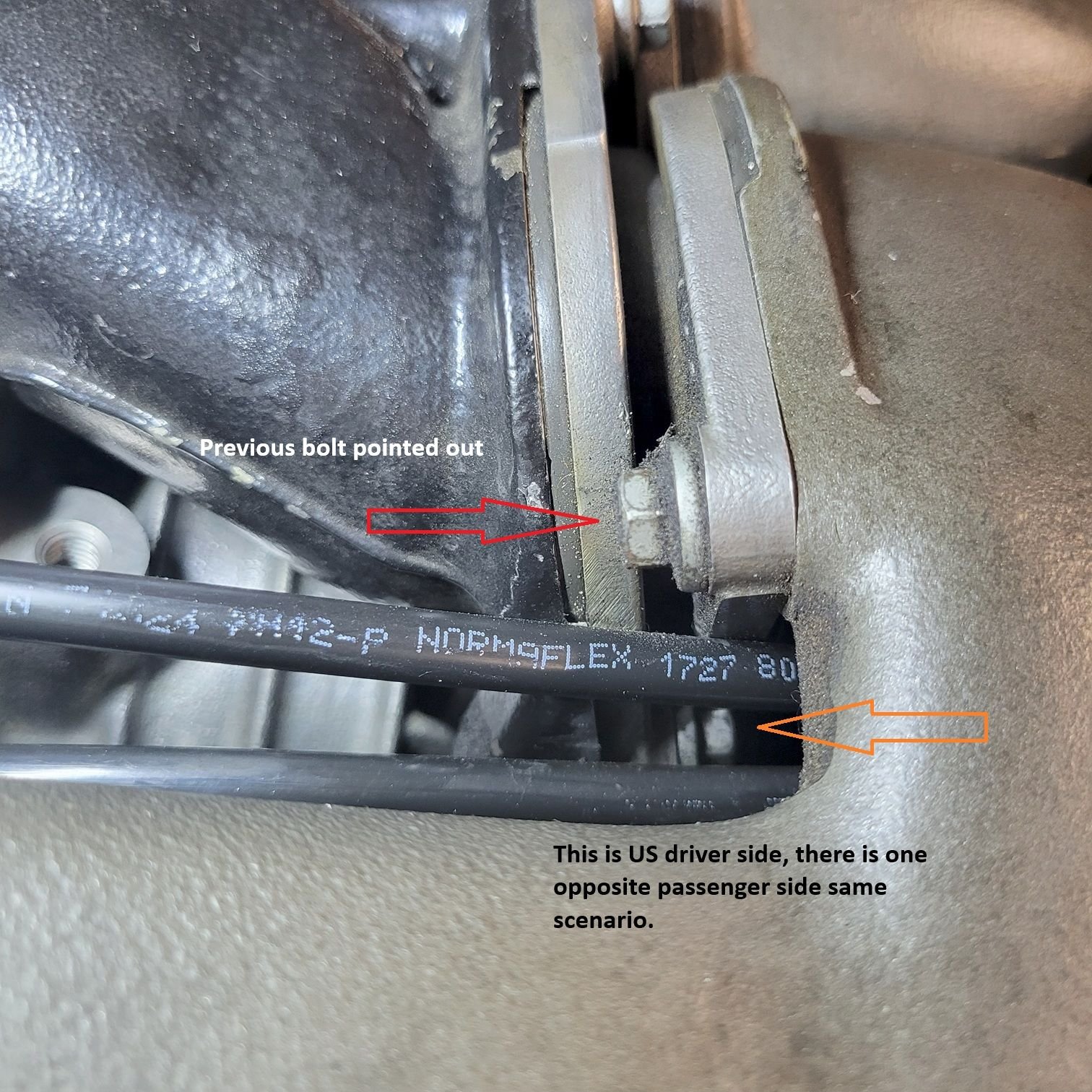

So, do you know if the clamp plate the duct seals (#3) have been upgraded? If I recall correctly, early models (like mine) had a smooth finish and the duct would suck out of the clamp with a hard acceleration. The newer ones (and upgrades) have a lip put on it. I replaced this so long ago I don't recall the exact details. Yours could also be old and simply need replaced for dry rot.

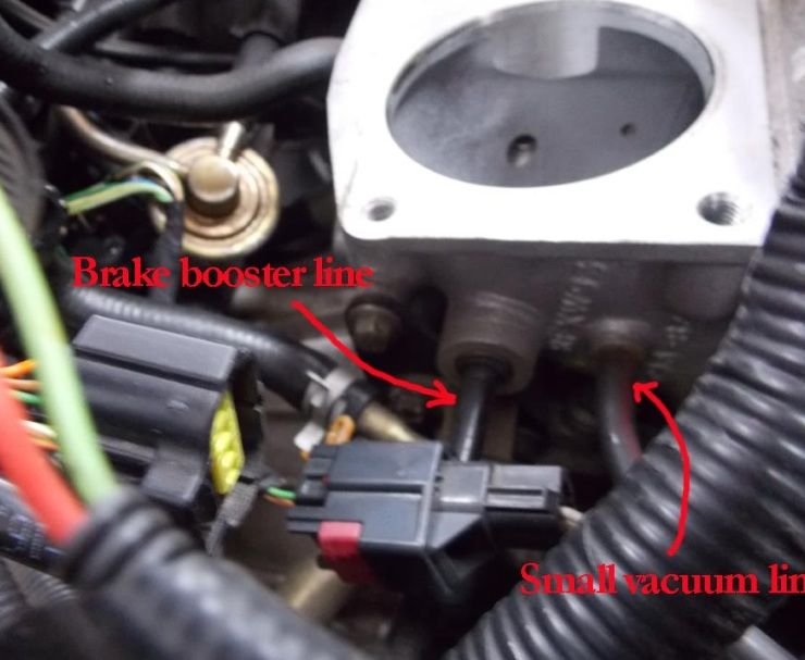

Another area of concern will be the brake boost line on the elbow into the SC on the passenger side. In the part pic I provided I do not know for sure if that is the one for the X308, please someone verify this. But, there is an o-ring that is well known to dry up, crack and cause vacuum issues as well....you can see it in the brass fitting. Thus when you step on the brake she can die. (added a real life pic of the brake booster line from someone's post on vacuum lines).

For this, the orange arrows point out the location of the 10mm bolts for the clamps. Reference the exploded view I posted above and you'll note there are (5) that they are attainable from just in front of the throttle body. (4) from under the inter-cooler using a 1/4" drive, 6-8" extension and a swivel (or bendy as the Brits refer to it), you'll be best served to have an extension tip magnet for the these underside ones. (2) are the easy ones from the top facing the front and thus a total of (7).
Now, after getting to those you'll want to loosen the 10mm bolts in the red circles (4 total on the corners, don't pull out of intake) then you should be able to slide it back and the assembly out. It's been awhile, I may have forgotten something, so please someone correct me if this is wrong.

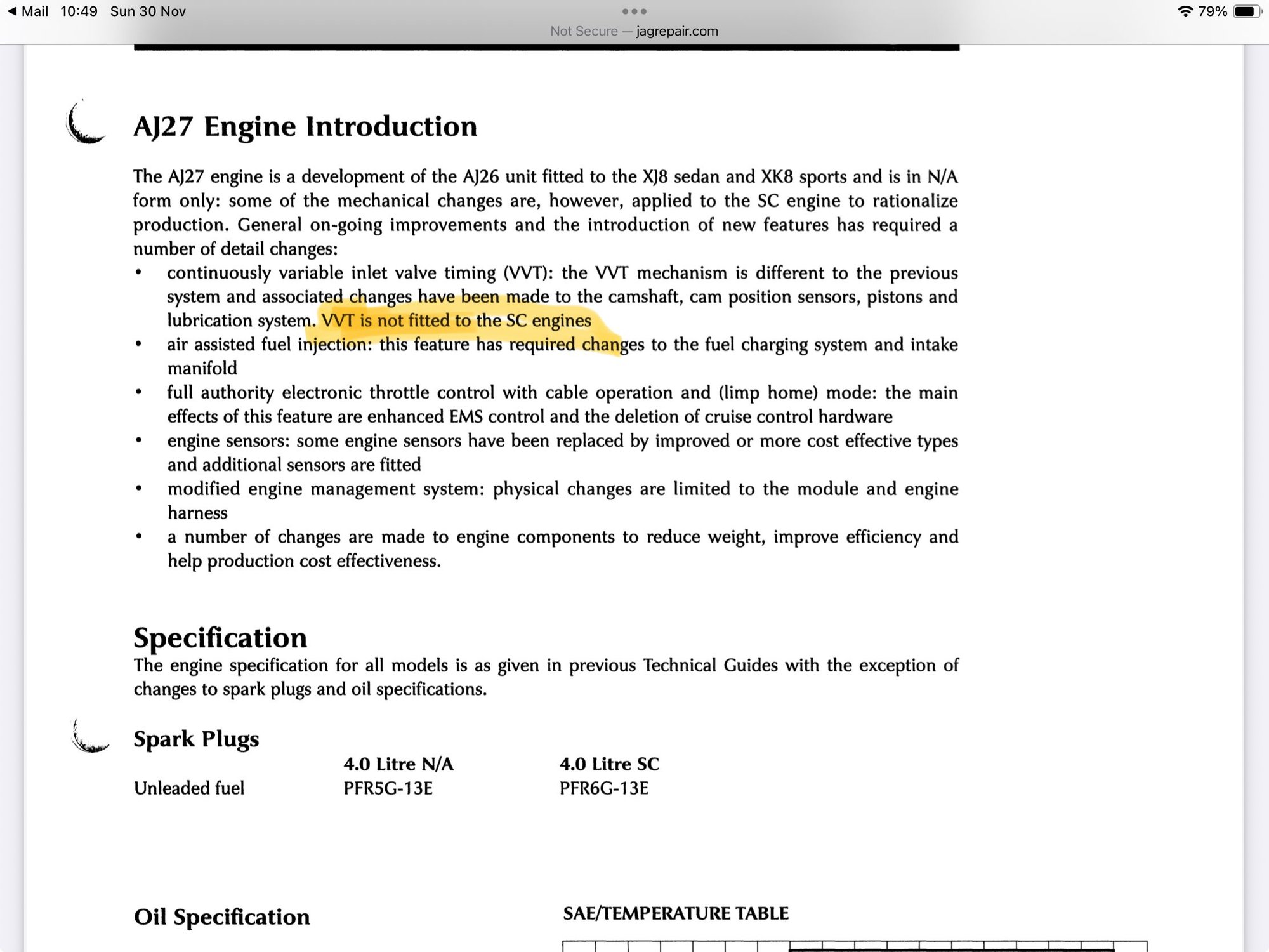

Jag has been using VVT since late '98 on the later AJ27 motor. On the 2000 AJ27 (EDIT: non-SC models) it was updated. Follow those instructions by blackonyx and you'll be fine. The newer all metal tensioners are all that is available. You'll see the kits from so-called other companies at different prices, but these cars are over 23+ years old and there is probably only one manufacturer making all of them just putting them in different packages. So don't think a $400 set is better than a $200 one. You will probably see them cross reference with the Lincoln LS from that same time frame because it's almost the identical motor. Ford did own Jag from '89 until 2008, the yellow connector on the back of the radio literally says Ford on it.

The supercharged cars do not have VVT.
Thanks for the correction Cafcpete, I'll go get a nice helping of humble pie.

I only remember because I have been reading the tech guide recently

It's been so long since I've had to get into mine, I thought they were on the AJ27 SC. But after reviewing, it's the later 4.2 and those after that have that setup. All good, I appreciate you correcting it.
