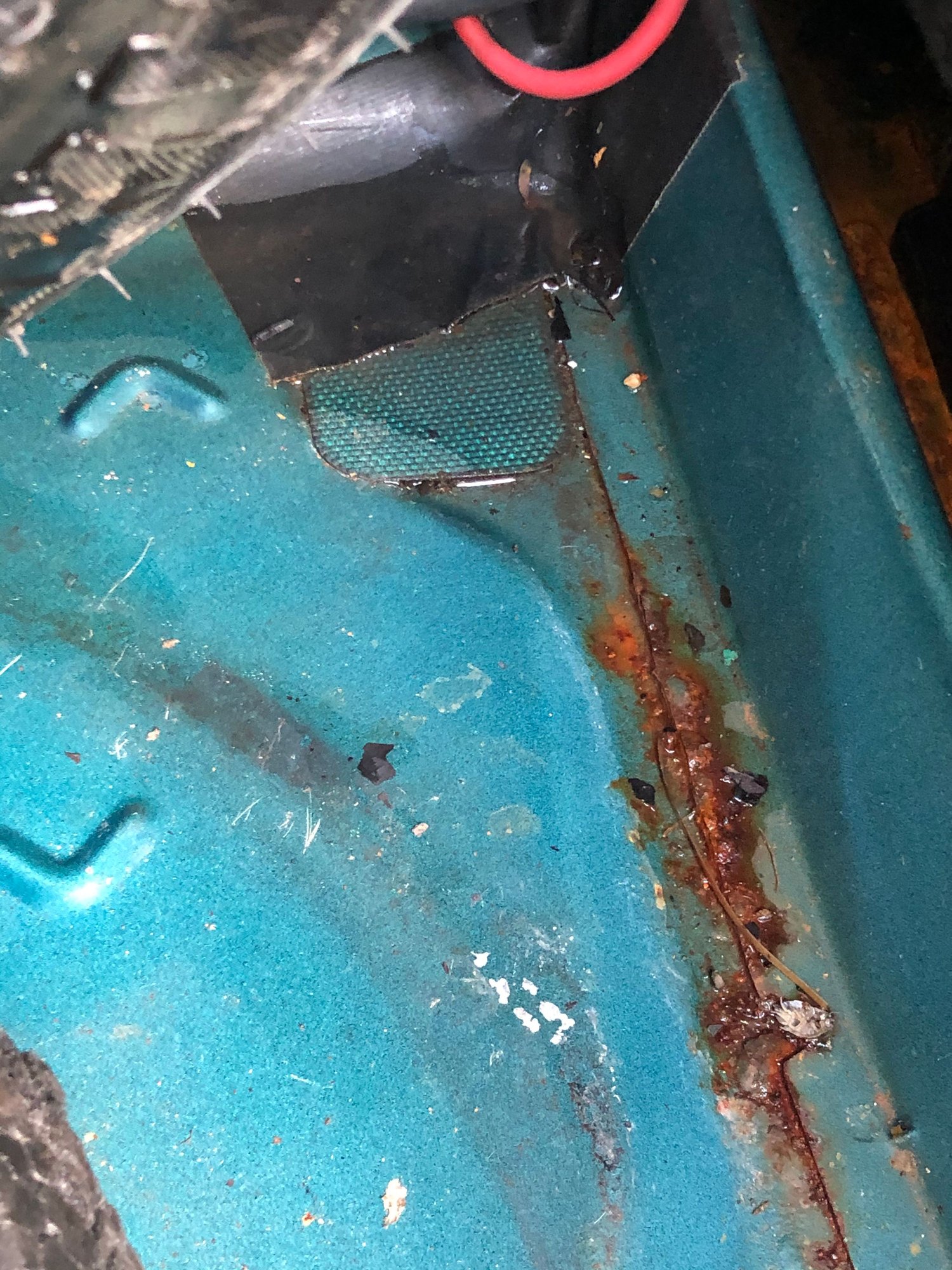

3. Puddle of water at the bottom of the boot, next to the spare tire. Not sure if there's a leak from rain somewhere or would it indicate another leaking pipe? i thought there are no hose at the back?
All Jaguar specialists workshop are booked (limited capacity with Covid-19) and I am not sure if I can trust other workshop on this. So will need to do some basic checking myself.

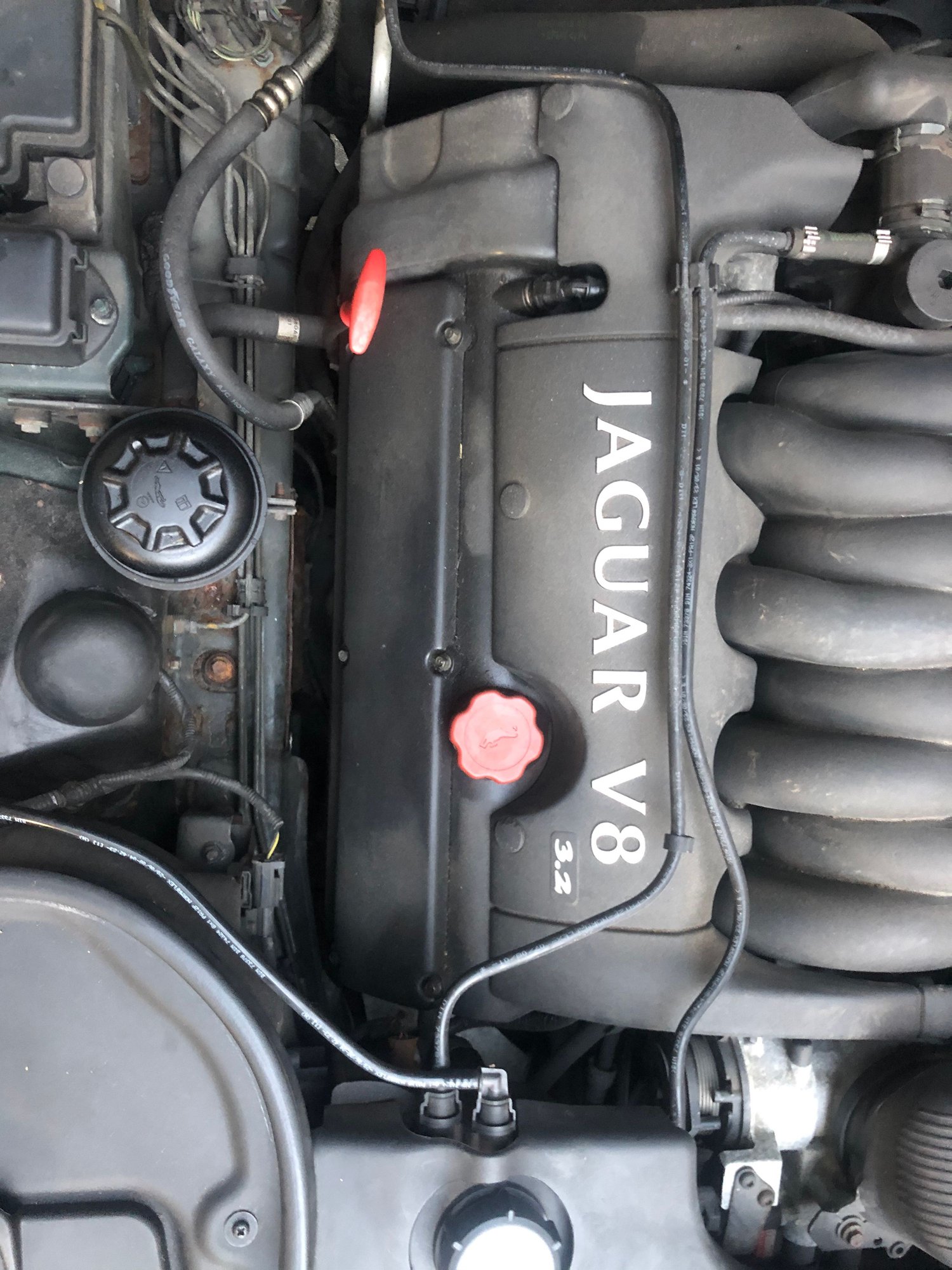

It would be very useful if you told us where you live. Water in the trunk (boot) indicates a leaking seal (or the previous owner left the boot open during a downpour). Does it overheat? Often, as not, a mechanic or previous owner had misrouted the hoses from the reservoir. They MUST cross over or you will blow coolant out of the overflow bottle in the fender. See picture for right way.
Then search around the water pump, thermostat housing, hoses, and the hoses to the heater at the rear of the engine, as noted by Jeroen. Thermostats and water pumps are known weaknesses. Check the oil for coolant (white frothy foam) or bubbles: see these, get your money back, you likely have blown head gasket.

Thank you for your respond! I live in London and have booked up a mechanics tomorrow. He doesn't have time but can have a look for me. The coolant was not clean with a bit of precipitent so not really bubbles, but is a bit orange milky. From the dash it wasn't overheated but it may also be broken thermostat as well if that's the case?
The pipe and hose looks correct. I will try uplaoding the video of the coolant tank when engine's on and after a few step on the gas: that shows a slow flow:

So the hose is correct at this moment.

After a long trip and been spending quite a bit of time with this lovely car, I am glad to report that it actually is all good. Got a full service done as well and the mechanics was very impressed with the condition! (Well, not the "top up with deionised water one") In the end I was a bit too nervous but this X308 just gave me a good lesson of don't worry be happy
By the way, the puddle of water really wasn't there anymore...I suppose the previous owner was really opening the boot in a heavy rain.
