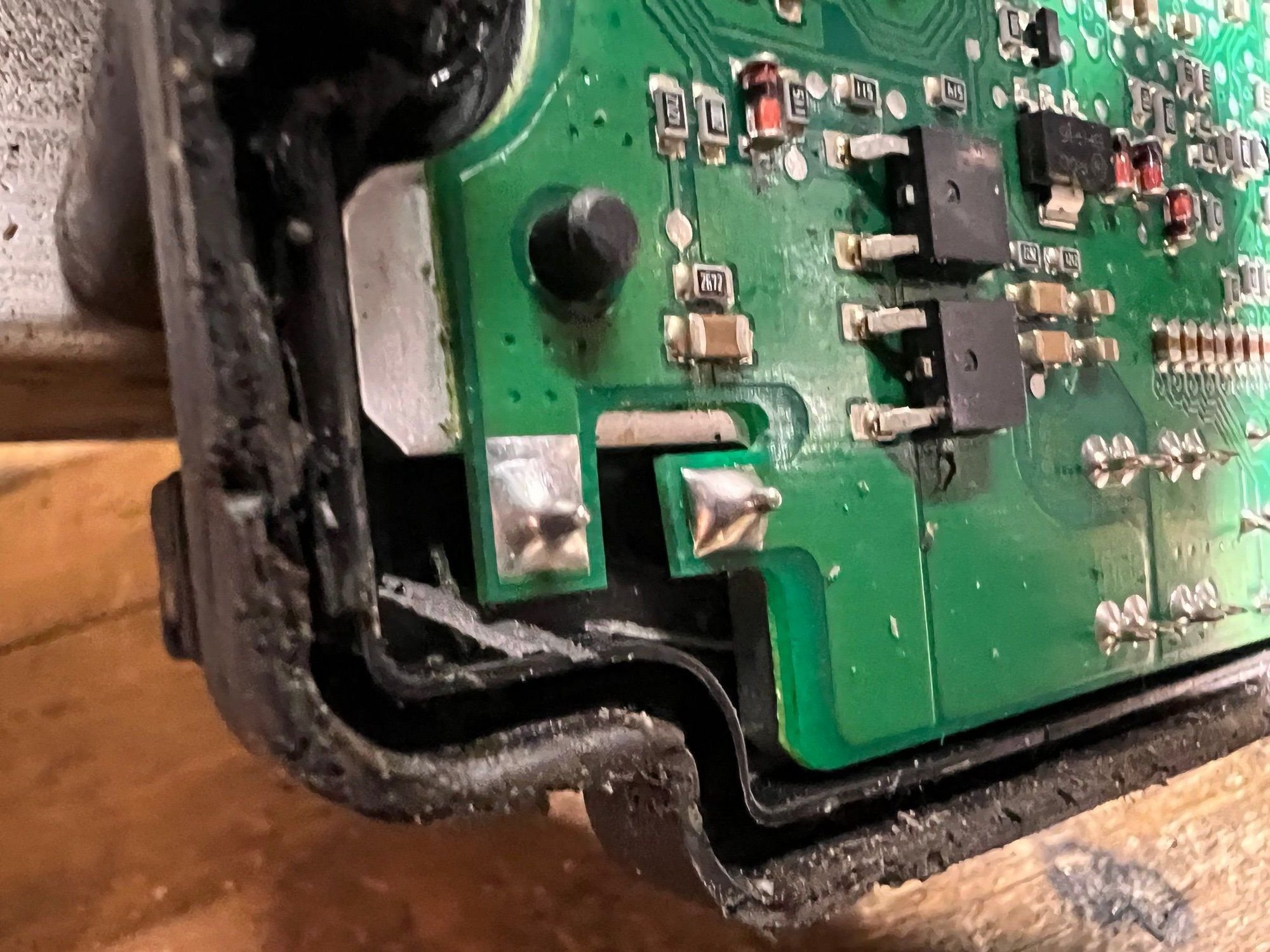

2. But sadly the most likely fault are cold welds (=cracked solder points) inside of the ABS module. The complete ABS-PCB was in a solder-bath during production for a fixed duration, and this time was long enough for all the smaller solder points, but not for the 2 big ones, where the power comes in - and this shows now - years later, There 2 big solder points need to be re-soldered. It's a bit of the struggle to get the ABS module off and on again, but I did that on my X308.
Here is a video about it - I have not seen the video in its entirety, but the important part starts at time 3:45:
I can't remember if I drilled a hole into the cover like shown in the video, or of I managed to pry the lid open...

pcolapacker sent me this pic of one of his ABS modules

Low voltage across the connection joint can cause the issue which is most
likely caused by the solder point weakness. Isolating the problem and completing
a refresh of the weld is the most effective manner of eliminating the warnings. There
is a lot of vibration at this connection which exacerbates the issue.
