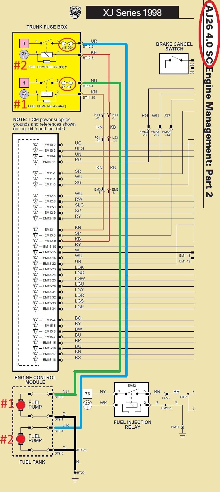

Old Mar 22, 2025 | 05:22 PM
Parker 7's Avatar
Joined: Aug 2021
Posts: 4,653
Likes: 1,318
From: Kansas City
Old Mar 22, 2025 | 07:57 PM
Nick M's Avatar
Joined: Feb 2024
Posts: 16
From: Indiana
@Parker 7 Thank you for the diagram. I jumped the relay with no response. I'll put a pressure gauge on it just to confirm.
Old Mar 23, 2025 | 11:44 AM
Parker 7's Avatar
Joined: Aug 2021
Posts: 4,653
Likes: 1,318
From: Kansas City
With a good ear you can hear the pump first 3 seconds from the cabin , better with the trunk fwd liner removed and listen in trunk
There is a fuel pump ground wire post for the pump alongside the battery area
So large 2 sockets 3 and 5 on the relay holder ? socket 3 should be hot at all times from battery and the big power fuse ( # 15 / 20 amp ) is after the relay
pic coming

Old Mar 24, 2025 | 02:18 AM
Parker 7's Avatar
Joined: Aug 2021
Posts: 4,653
Likes: 1,318
From: Kansas City
With the normally aspirated you will only have the # 1 pump , Supercharged 2 pumps
With the crash / inertia switch it is fickle and does not always reset from reading others , this crash switch only effects the control of the fuel pump relay and not a direct powering by jumpering socket 3 to 5
You can use a paper clip between wire X and wire Y of the connector , paper clip works fine for my inline 6 X300 with different wire colors
