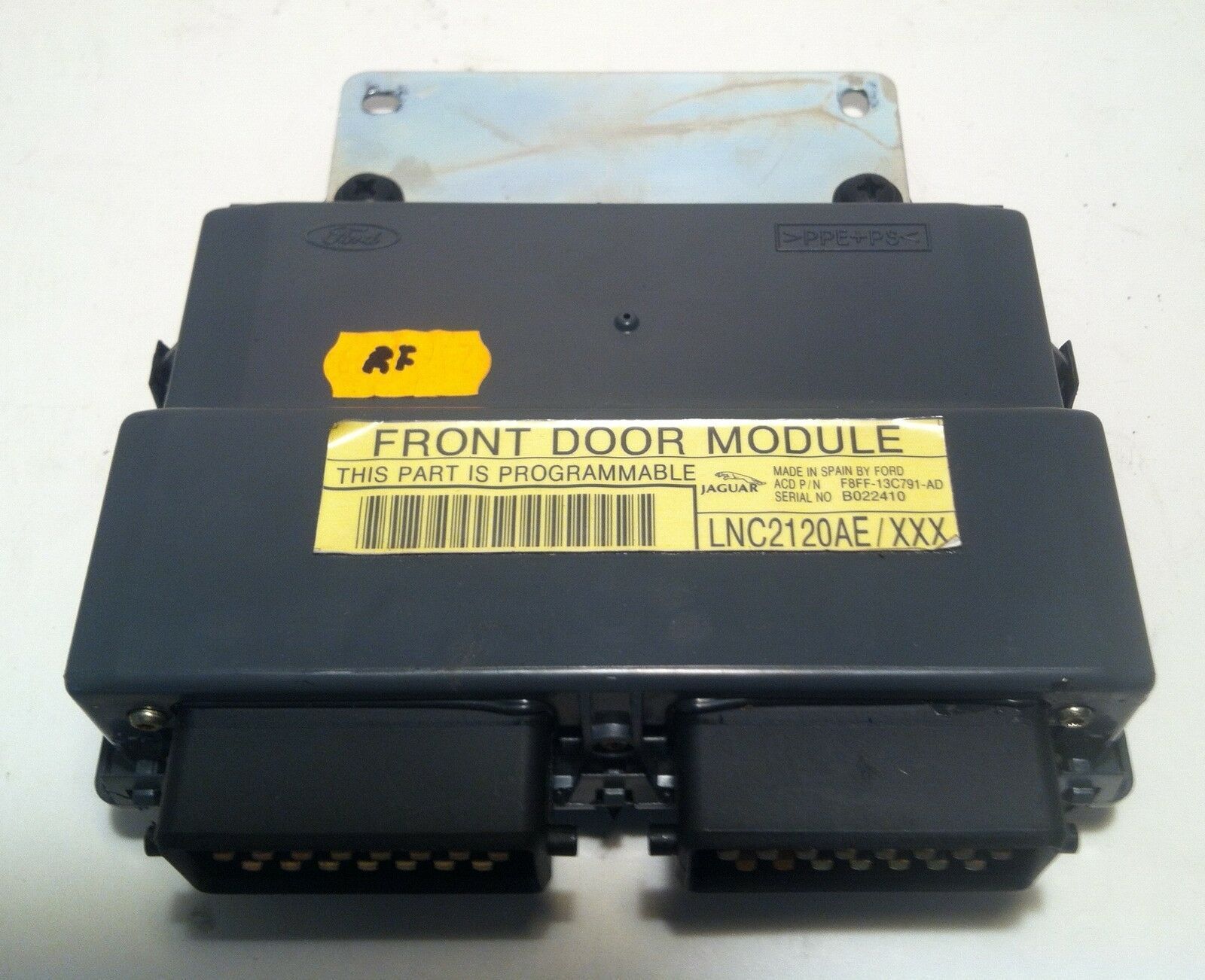

Old Nov 13, 2021 | 07:25 AM
3timejag's Avatar
Joined: Apr 2015
Posts: 480
Likes: 19
From: Jacksonville, Fl
Is this what I need to replace?
Old Nov 13, 2021 | 07:27 AM
3timejag's Avatar
Joined: Apr 2015
Posts: 480
Likes: 19
…or this..
Old Nov 16, 2021 | 10:57 PM
Vauxi's Avatar
Joined: Jul 2019
Posts: 817
Likes: 178
From: Finland
The latter one. Not the door module.
