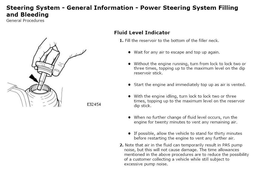

This is the filling and bleeding procedure. It is done with both front wheels off the ground.

I did not know that. Searching the workshop manual, the only reference to a filter that I saw said that the reservoir "incorporates a 10 micron, lifetime, integral filter". How would I service the filter? Thinking I would remove the reservoir and clean it up in a parts washer maybe? I suspect that by gently flushing cleaning fluid through the hose ports would probably clean it. I have an ultrasonic parts washer too which might work better. I will definitely go down this path.
I will also follow the bleeding procedure more carefully as M. Stojanovic posted, and hopefully between those two things I can eliminate the noise. Otherwise I might have to tackle the pump again.
