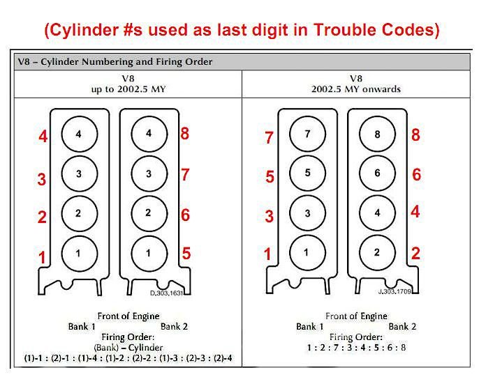

I have had the RP many times & was frequently an ignition coil.
If coil #6 may get these codes:
P0306 cylinder 6 misfire detected, generic code
P1314 misfire catalyst damage bank 2 engine mechanical fault
P1316 Misfire exceeds emissions
1 # changes depending on the specific coil.
1 by 1 over the past decade I have replaced 7 of the 8 coils. I'm sure in the next year I will get it again & replace that 8th coil.
It is easy. I always use genuine Jaguar coils. There are threads here with instructions on replacing the coil.
If you are unsure it is actually a bad coil, you can always swap coils.
Example. Your OBD2 says coil # 7 is bad. You switch #7 with #8 & clear codes & see if when you get the RP again it now says coil #8 is bad. That would be your proof.
