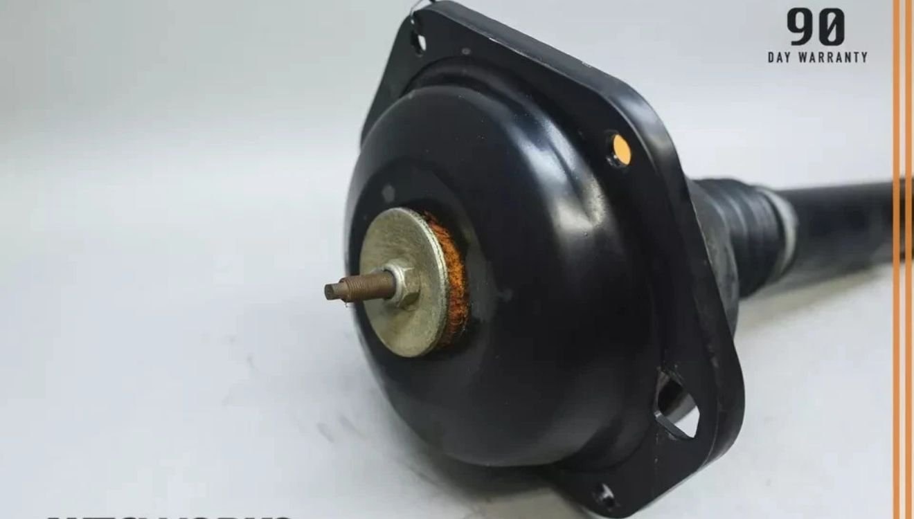

Having trouble finding replacement info for the 4 bolts on the rear shock mount plate. I will be changing the rear shocks soon and I estimate that there will be 87.5% chance that I snap a bolt or two off since they are so seized with rust

M8 x 1.25mm 'paint clearing bolts' are what Jaguar uses but any M8 bolts will work that are 25mm to 30mm long.

thank you Motorcarman - I appreciate that. Best case scenario I can reuse the original, worst case scenario I’ll have the tap and die set handy 😅
