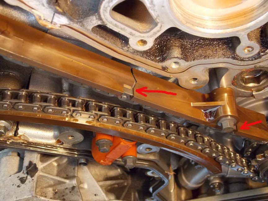

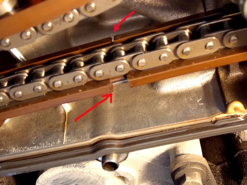

Robert,
It is true that it is the upper tensioners that suffer from earlier deterioration than the lowers, but the lower tension guides crack and begin to break up at a similar time/mileage. This doesn't cause the tooth slippage of the upper chains, but the broken parts of the slipper guides are not desirable in the engine internals, and the lower tensioners are plastic, and I believe will eventually suffer from the same fate as the uppers.
To do the complete tensioner job is a bit of a PITA, but for longevity and peace of mind I would recommend it over just replacing the upper tensioners, especially if you intend to keep the car for several more years.
Here are pics of my lower tensioner guides at 70,000 miles/17 years old.

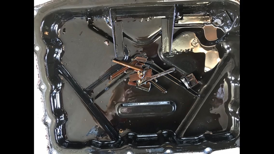

Default Debris at 91 thousand miles
Detritus in oil pan. Broken bits from the lower timing chain guides and upper tensioners.
I removed the pickup tube and washed all the broken bits out with hot water and Dawn dish soap in the sink .
Plus the guide rail broke off completely rubbing and could have jammed the crank gears.
​​​​​​​i did the secondary tensoners, still had a nasty rattle. Completed all of it
