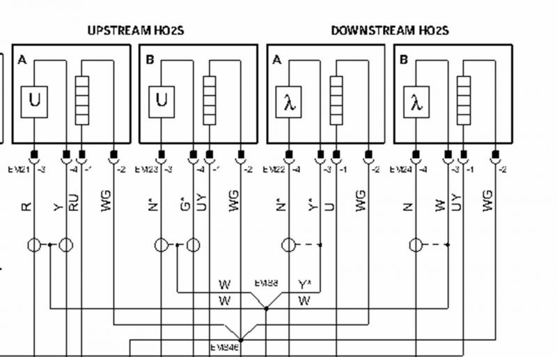

I assume you have the JTIS schematic to ID the correct connections-
Old Dec 10, 2011 | 06:49 AM
ant17's Avatar
Joined: Mar 2011
Posts: 473
Likes: 17
From: Tucson
I do, trying to locate on the CD.
Old Dec 10, 2011 | 09:18 AM
sparkenzap's Avatar
Joined: Nov 2007
Posts: 4,502
Likes: 1,068
From: atlanta ga
Upper right on diagram 4.1. page 54 of electrical guide, accessed through the wiring looking icon, then section 4 (electrical), at least in my version 1.3). The U wire refers to blue, the UY refers to blue with a yellow stripe- R is red and so on. Its a little complicated to describe the wiring for each, so its best you have a look at it.
Old Dec 10, 2011 | 09:33 AM
sparkenzap's Avatar
Joined: Nov 2007
Posts: 4,502
Likes: 1,068
From: atlanta ga
See if this helps- A Bank is right side, of course
