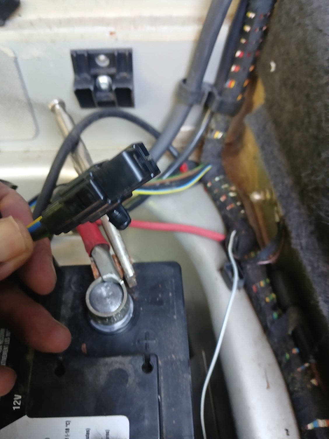

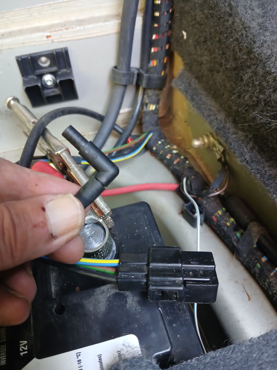

I recently had the fuel pump replaced and noticed two things that don't look right. One is a plug and the other is a small hose. I'm assuming a vacuum linr
This is the plug
This is the hose

The plug in the top photo is normal. Just tuck it down behind the battery.
The second photo is a breather hose for your battery. It should be plugged in.
It plugs in the top of your battery under the hold down bar.

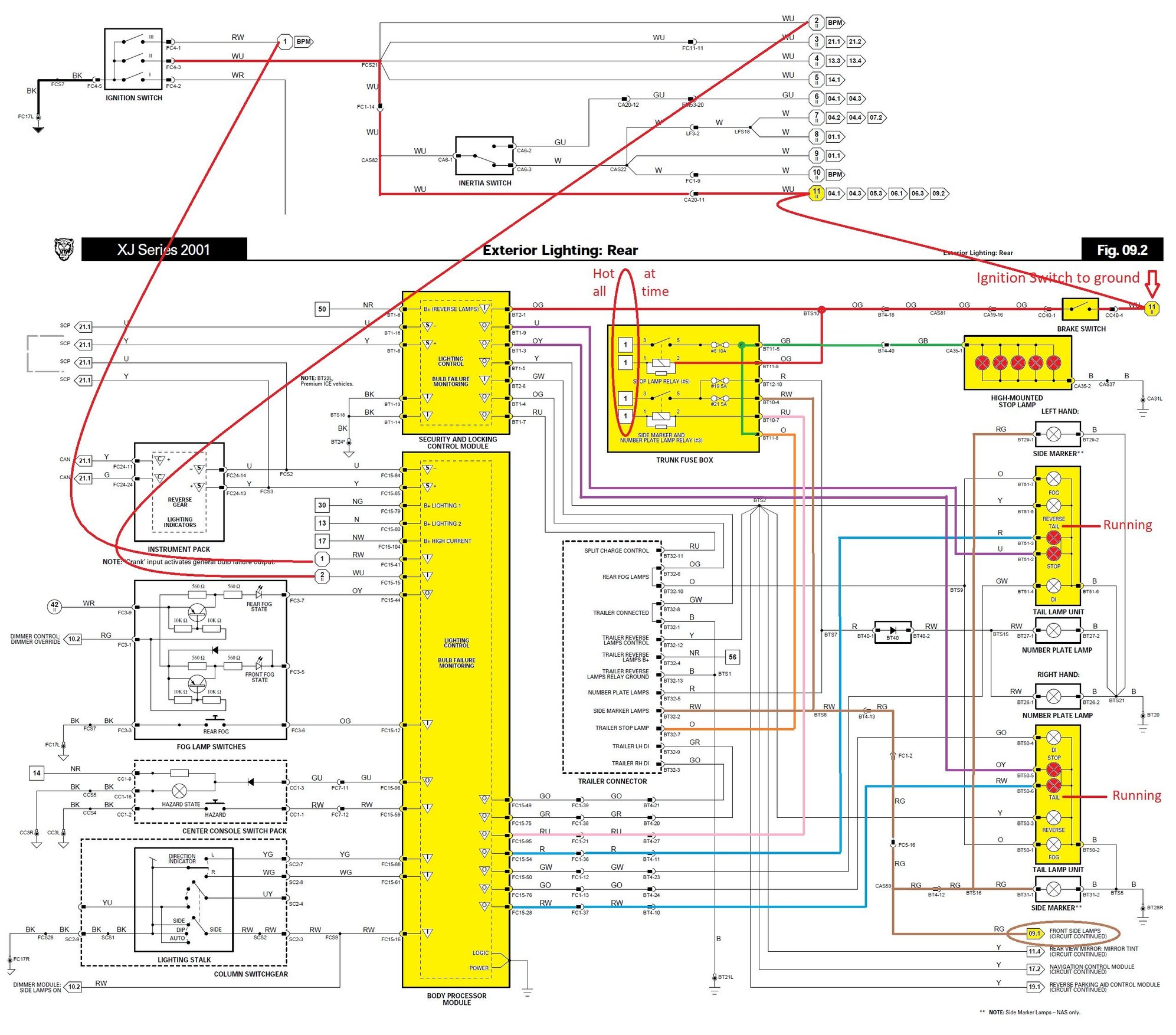

And no need to post a question about the single wire for the TRANSIT RELAY. (it doesn't connect to ANYTHING)
Old Sep 15, 2024 | 04:56 PM
Parker 7's Avatar
Joined: Aug 2021
Posts: 4,637
Likes: 1,312
From: Kansas City
Which year is your X308
this pic may cover your year
The SLCM is located above the fuel tank and the connectors may have been disturbed
Remove battery positive post and fully remove and reseat the SLCM connectors
The inputs to the SLCM in the pic's left may have been effected
