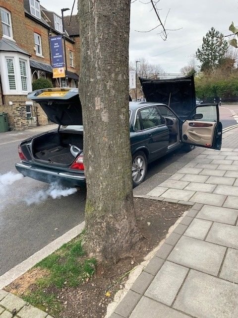

I'm over the moon
Bore wash did the job (I had my doubts). I took of all the spark plugs and squirted oil in the cylinders.
May have gone overboard on the oil but once the smoke cleared everything was running perfectly.
Thanks for all the help
