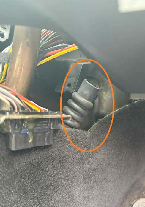

By concertinaed you mean ribbed like the one off the air intake?
I’ve switched dashes in an XJ8. I don’t remember a ribbed one. I think there is a drain pipe. Posting a pic may help.

Hi everyone, many thanks for your replies, its taken a few days for me to get back on with the car, so apologies for a delayed reply.
Following pcolapacker advice I took a picture...
it does look like a drain, breather type of pipe, I just cannot find anywhere in Jag manual as to where it fits. I want to get this right as pulling the dash out again is not a small job lol

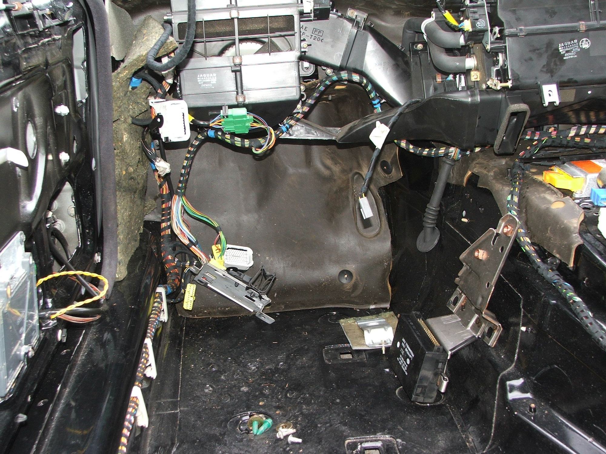

There is a plastic pipe from the evaporator (main climate control box) on each side of the transmission tunnel that goes into that bellows. If you want better pictures, search up “Evaporator time” using my screen name. I took quite a few pictures.
