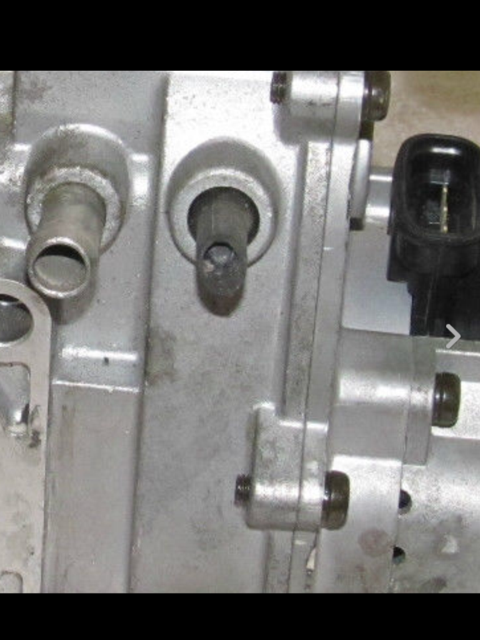

I removed the throttle body from my parts car, and without thinking i removed the black rubber tube on the bottom. Shown in picture. I'm not sure of the technical name for it, but I'm going with "black hose cut at an angle."
Does anyone know where to get a new one? Or do i have to go digging thru the trash Thanks!!

Looks like the hose from the throttle body to the water pipe -
1998 Jaguar xj8 - part# NCA3246AB - gaudinjaguarparts shows list price of $10.25 discounted down to $8.32 with shipping at something less than $14.95 (their standard shipping/handling)
You can call them to get a lower shipping estimate.
Here is a weblink to website that has a photo of the hose:
Jaguar Coolant Hose (XJ8 Vanden Plas XJR) - URO Parts NCA3246AB | FCP Euro

Rock auto parts sells 1998 Jaguar xj8 - part# NCA3246AB for $5.95 plus $6.14 priority mail (2 to 3 business days). Hose dimensions are 3.6 x 3.2 x 0.8 inches (1st and 2nd are probably Width and Length, 3rd is Diameter ?? ).
Here is a better photo of it on XJK LTD - here is the weblink:
http://www.xjkltd.co.uk/p/jaguar-nca3246ab-922.html
Jim Lombardi

I am thinking that you are looking at a vent orifice with a rubber tube.
I imagine that the angle cut tube is to prevent the ingress of water or debris (splash guard???)
I don't have an AJ26 throttle body handy to look at right at this moment but I think I remember them having this feature.

Look at parts lookup on the jaguar classic parts webpage - parts list - item 14 hose - to vin 853935 - part# NCA3246AA, (Water Pipe Hose), also item 11 Pipe (Water Pipe) - part# NCA3148AA.
Also view the diagram for these 2 parts - item 11 and 14.
Throttle Body-Air Assisted Fuel Injection - Parts For XJ Series from (V)812317 to (V)F59525 (X308) | Jaguar Classic Parts UK
bob gauff
Yup...I concur with that Bob....a normal standard feature.

I found the piece in the trash can. It does look like a vent orifice rubber tube of some kind. Looks like it probably comes with the throttle body. Thanks for the help everyone. I'm just glad I found it without having to really dig too far.
