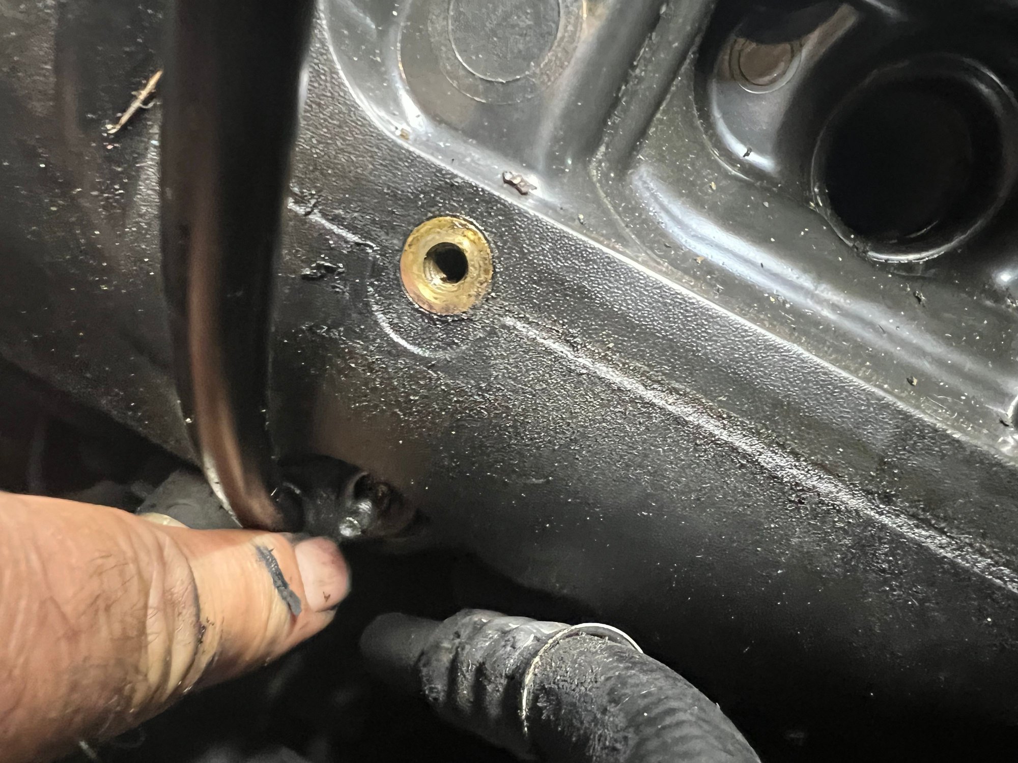

Replacing valve cover gaskets. How do you access bolt under the dipstick connector? I’ve read if you pull the dipstick it’s a beast to get back in.

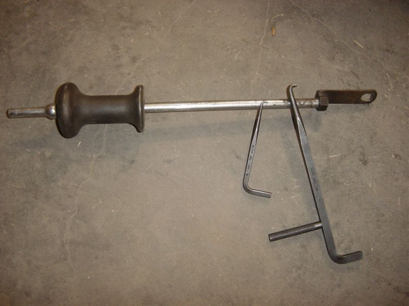

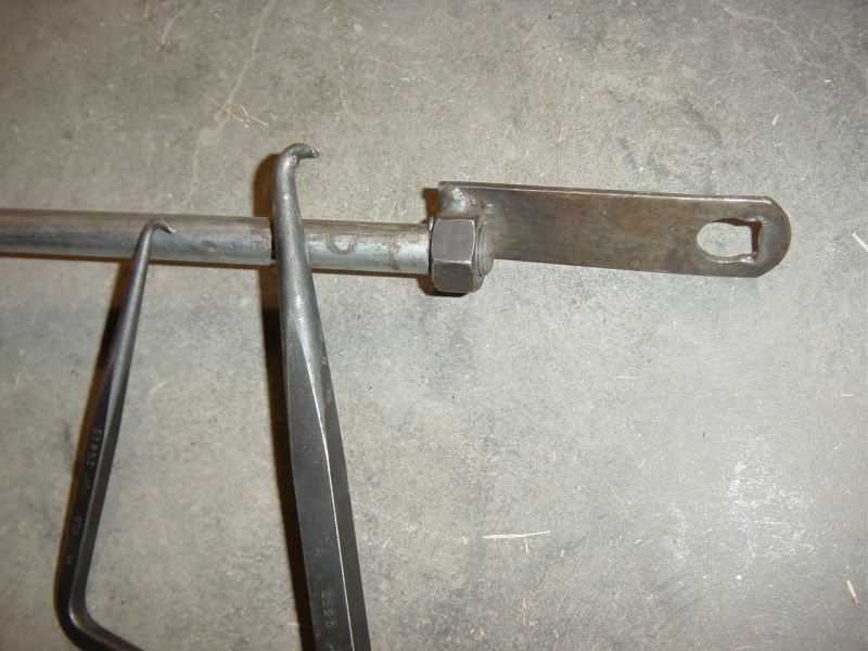

I use a SEAL HOOK and the slide hammer has a nut welded to a flat steel plate with a hole drilled to fit the seal hook 90 degree handle.
The 'hook' just catches the welded part that bolts to the stud.
I put the hook under and slide the tube out and up an inch.

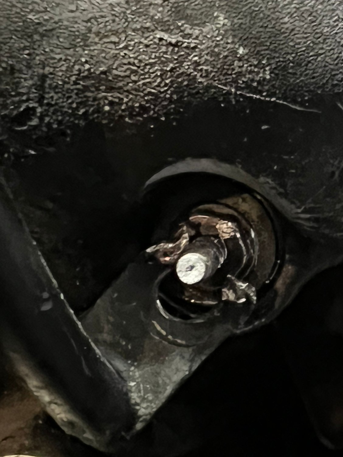

I did the @Peter_of_Australia method. Used a drill to cut sideways to make a “C” out of the “O”. Nut will still secure. I’d never cut the parcel shelf to replace a fuel pump but this work around was acceptable.
