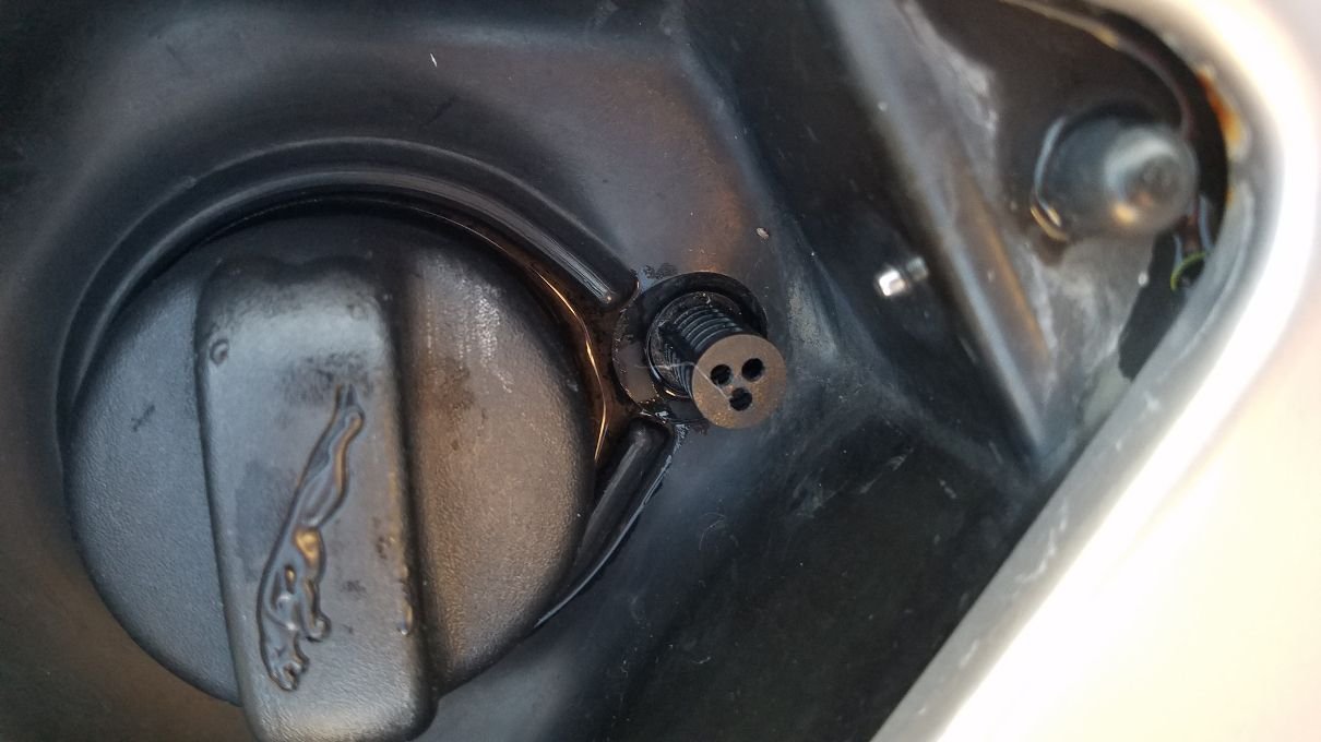

I had some debris in that bowl so opened flap & shot the hose in there to clear it out. The water rose all the way up & would not drain.
I had to use paper towels to soak it all up.
So there must be a clogged drain.
I found 2 similar posts for X100 & X300 but nothing for X308.
https://www.jaguarforums.com/forum/x...p-area-217726/
https://www.jaguarforum.com/showthre...l=1#post748257
Post by Ovhk shows a diagram for the X300 & my X308 also has that rubber nipple with 3 holes in it. #2 in the diagram.
Do I remove that & then poke something down the tube?
How do I remove it? Does it pull up or screw off?

I used 100# picture hanging wire & was able to feed 24” into each top hole in succession feeling 0 resistance until 24” reached.
I didn't see anything on the wire. I filled a cup with water & slowly poured into the scupper or bowl or whatever it is called.
The water all drained!
I saw it on my driveway. It seems to exit in the center line & not at the driver side.
I will try to remove that rubber nipple anyway since I want to take a good look at it & see if I can eyeball a filter. If I can clean it & run water directly down the tube, I may do this every year.
Old Apr 25, 2020 | 10:42 PM
Iconoclast's Avatar
Joined: Nov 2010
Posts: 500
Likes: 93
From: Arizona
I was easily able to wiggle the black, plastic nipple free. Exposing the hole for the drain tube. Mine is not mesh. It is black plastic with openings along the sides & 3 holes at the top. I thought there would be a mesh filter revealed between this plastic nipple & the hole.
I rinsed it off & then washed it with soap & rinsed again. I poured another cup of water down the open hole & wiped the scupper. I now see that the water does drain, underneath, closer to the driver side than the middle, as I previously stated.
So, I think that black plastic nipple IS the filter.
See photos
Thanks to all who replied/helped!

Any tips on getting the filter back in, I've pressed mightily even tried to twist yet it's still loose & prone tip over ?!
Old May 1, 2020 | 05:27 PM
Iconoclast's Avatar
Joined: Nov 2010
Posts: 500
Likes: 93
From: Arizona
You are putting it back in upside down in that photo.
Also, look carefully at my 3rd photo. The one with plastic filter removed. Are you missing a rubber grommet?
