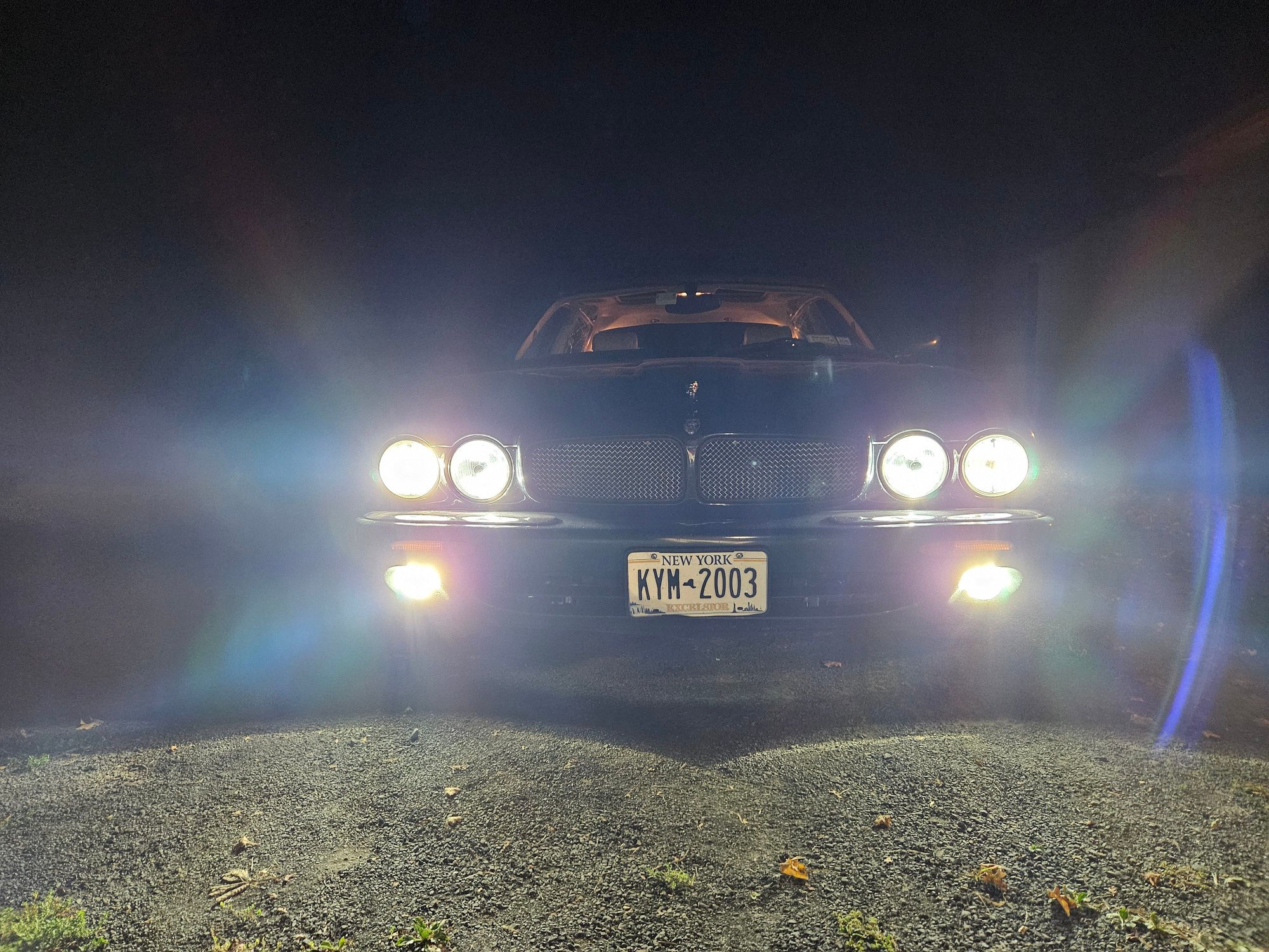

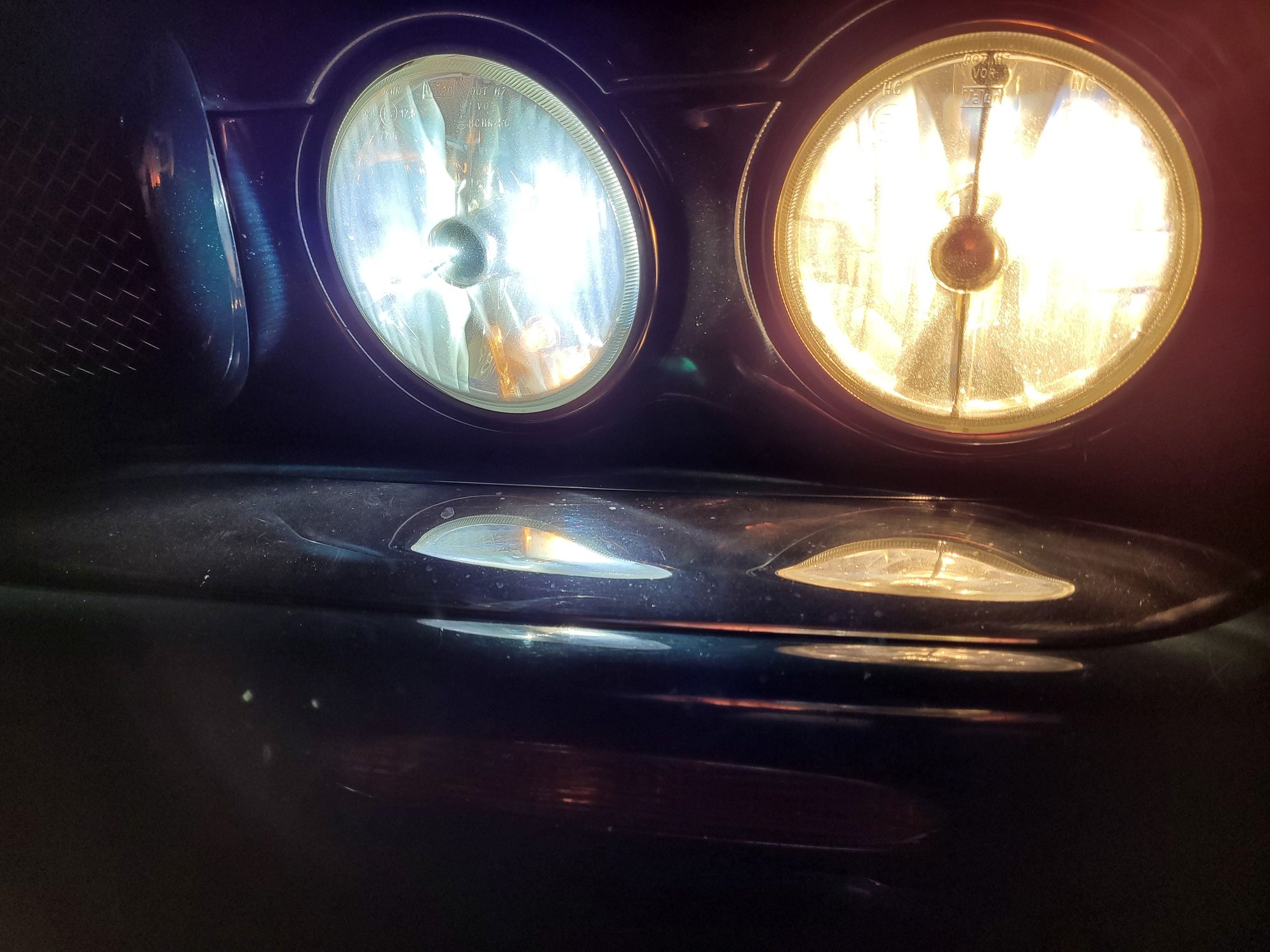

I installed a set of fanless 6000k H7 LED bulbs in my high and low beams in early 2023 to replace the halogens. Light output is significantly better, I never get flashed by other drivers and they've lasted me about 40,000+ miles so far, no failures and no flickers. I also replaced the fog light bulbs with the same color LED as well as the little chicklet running lights that go in the high beam housings, so its all the same color. Working great, and they were inexpensive and I didn't have to do anything to modify the anchor points to get them to sit securely in the housings. First photo is LED high beams, halogen lows, second photo is all lamps replaced.

I think LEDs must use a different scale or something. The ones I have are listed as 6000k, which if I were using HID lights would be well into purple (i had a set of HID bulbs in a VW that were 5000k and they had a blue hue to them when looking at the car, but the light on the road was pretty white), these are white as can be, not a hint of color to the bulbs or the light on the road. Its weird and doesn't make much sense to me, but seems to be accurate, at least in my limited firsthand experience.
My understanding is that the color-temperature scale in kelvins is the same for all visible light-emitting sources, but different standards of what constitutes "white" do exist. For example, "D50 is scientific shorthand for a standard illuminant: the daylight spectrum at a correlated color temperature of 5000 K." (Wikipedia)
My assessment is that various vendors of incandescent, LED and HID bulbs are not scientifically accurate in the ratings the ascribe to their devices, because I've had 5000K bulbs that were very blue and 5000K bulbs that were close to white (to my eyes).
Also, human beings perceive light differently from one person to another. For example, in the photos you posted, to my eye, the high beams are many shades more blue than the low beams, which are significantly more yellow. But capturing emitted light in photos is difficult, so what you see on your car in real life is likely very different from what we see in your photos.
