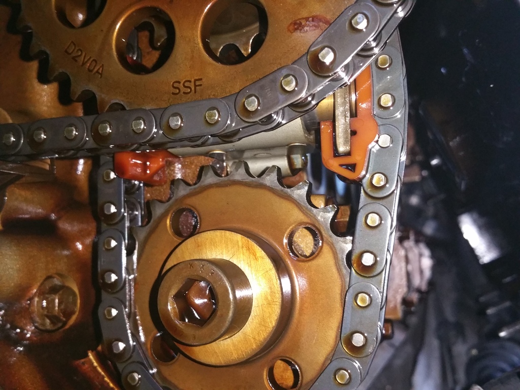

yeah guys i ended up pulling the came covers for better sleep at night loll and this is what i found....
i also called a few jaguar dealerships and gave them my VIN number and only two out of about eight dealerships were able to tell me that i have metal ones....but i do not know how they got that information....either they knew from the engine build or the last owner had them changed from the dealer? but who knows i still wanted to confirm and that is what i saw on both sides now i can sleep safely at night!
i do appreciate all the helpful hints peoples!

Your '01 car came with plastic tensioners. Unless replaced under warranty the Jaguar corporate data base would not have a record of the work. Only the servicing dealer would have such a record and many have lost or archived records from many years ago.
